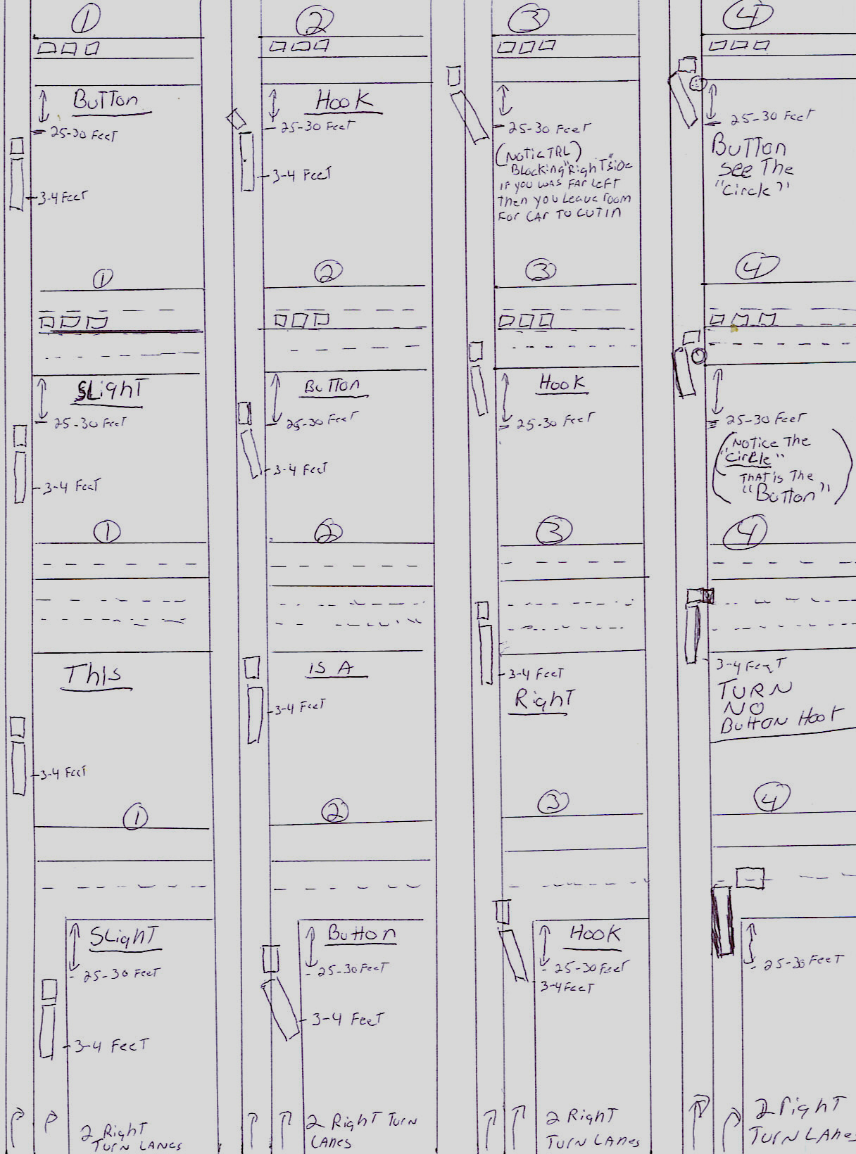

    This maneuver is not called as a button hook.. This would be considered a "right turn" where is the "button"??????? The point of the word "button" is to make a rounding turn like a "Button", This would be using all the space necessary to make a tight right turn.... Pulling strait out into the inter section and turning right is simply a right turn..
    This is called a BUTTONHOOK not a "jug handle" lol... Simply Google "truck "button hook" and you will find tons of information describing the turn I explained.. Google "truck jug handle" and your going to get a type of actual road turn" (some intersection, I have mostly ran into them in NY city called jug handle.. The road itself is shaped as a jug handle.. LOL not a maneuver shaped as a jug handle) What school did you go-to? they should be using a common trucking language
    This is absolutely not true.. If you do approach in this manner you are leaving yourself open for someone to slide in on your right side.. An accident waiting to happen here.
    what you are saying here is if the is a second right turn lane then it is okay to use it? okay then you would be again setting yourself up for someone to slide into your right side.. You need to keep your trailer in the right lane to prevent a car from entering your right side and use the second left turn lane to buttonhook if needed... this would prevent someone from cutting in on your right side..
    If a button hook is needed then that is the distance you need (varies a bit with how wide a road is, how many lanes you have to turn into ext..)
    Hum I am not the only one who knows you should start 25-30 feet back in order to do a button hook (again the space needed varies and only is learned with experience but as a beginner you should always start setting up at this distance until you have the experience to judge what you will need)
    Okay I guess I am now compelled to draw a diagram.. LOL call somebodies company, jeez we have another one on the road...
    LOL okay there you Go, Its rough but you should be able to get the point.. Click on link or pick
    (I could post the actual pics out of the CDL guide but then I would be risking copyright so here are some drawings you all can laugh at, due to my well drawn pics lol)
