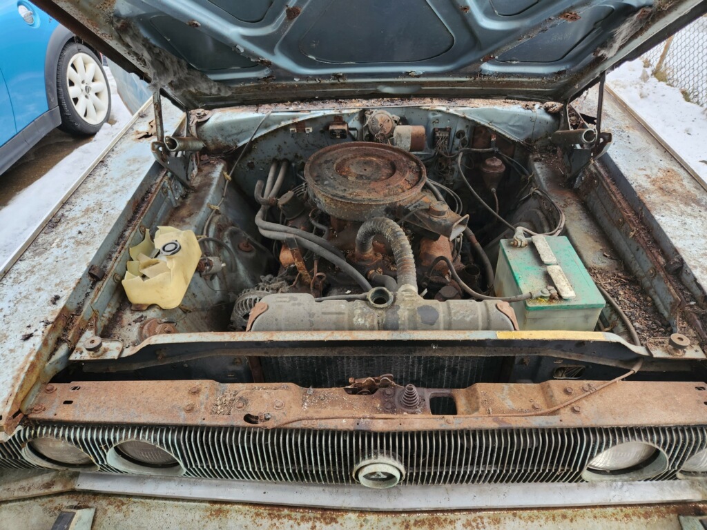

    While I'm getting the motor to turn,
    I think I should have bumpers chromed,
    and all the interior parts to be sent with it.
    It has 4 bumperetts that were Dealer
    add on options in 1966.
    I have a torpedo heater pointed toward it,
    on low, right now - to drive out all the moisture.

    Time capsule. I love it. I’d just get it running, thoroughly clean it, and drive it as is.

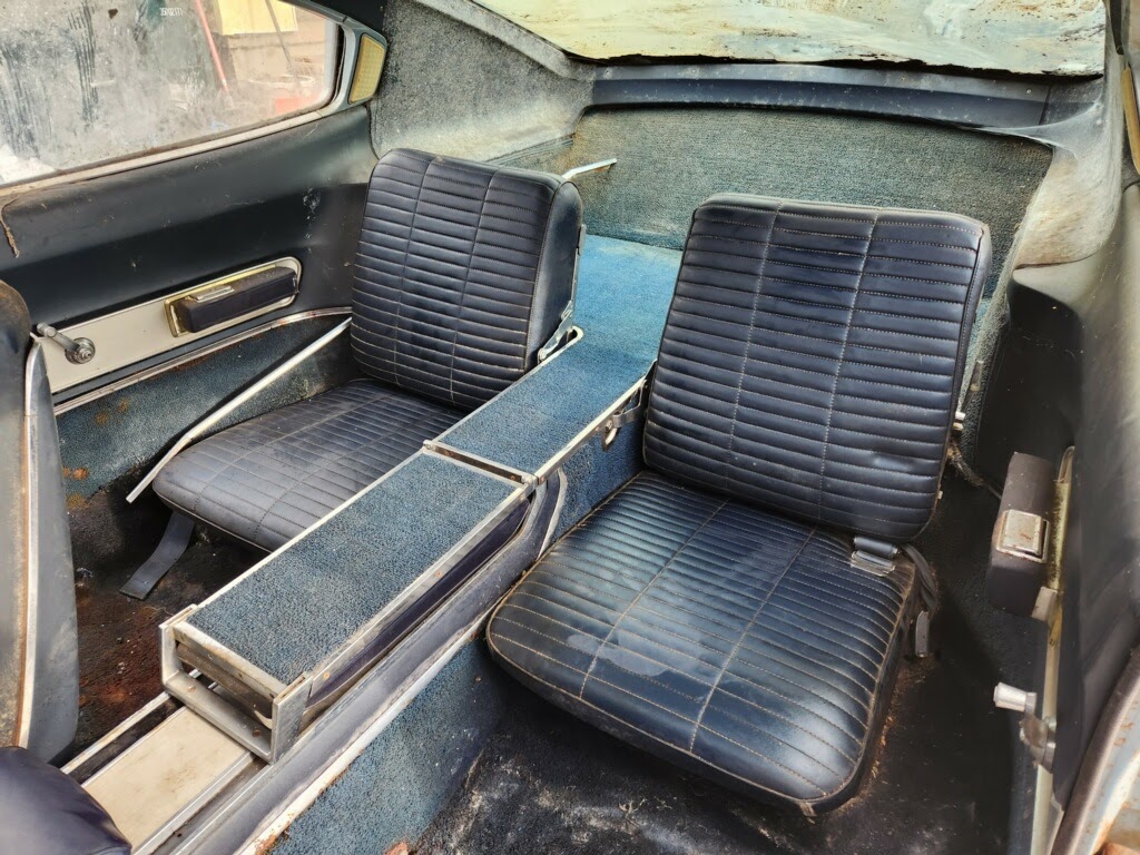

    the interior needs to go
    and new carpet set installed,
    after I get it up on lift to check floors.
    Seats need redone to get the odor out of them.

    A good auto upholstery shop can do wonders for the seat foundations, while keeping the original covers. The odor is going to be in the foundations. Likewise, a good steamer can clean the carpets.
    I had a carpet/upholstery cleaner do an interior in a Subaru for me. I removed the whole thing and dropped it off at his place. The previous owner was disgusting and I’m pretty certain one of his kids vomited in the back seat. It was left in his backyard, for several years, closed up. It was a 2yr-only model, highly desirable, and worth saving. I bought it out of a junkyard, where I’d just happen to be, when it was brought in. Now, I forewarned the upholstery cleaner of how bad it was. Upon seeing and smelling it, he said it was the most disgusting interior he’d seen or smelled. It was THAT bad. He gave me back a pristine interior with only two tiny spots he couldn’t get out of the rear carpet. That disgusting funk was completely gone. Reinstalled, it looked amazing.
    This is a ~140yr-old chair I had an award winning upholstery shop rework. This chair was in several pieces and still had its original foundation, believe it or not. It looks like new.
    A good upholstery shop can work miracles. You just have to find/know the right one. I’d at least investigate saving the original stuff.

    Agreed; I will look into conservation, rather than restoration.
    It's only original once.
