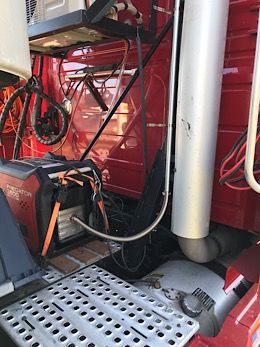

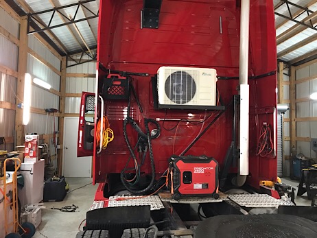

    39886095-21E4-42A0-B0FF-8658209B1E76.jpeg 10B64F4B-549C-4169-A5CB-25E062BA5F19.jpeg 161C1303-3E05-4AF3-BC88-B7C0B2171D65.jpeg
    Can hardly hear the generator and the inside unit is absolutely silent.

    Everything is very solidly mounted. So far no trouble, even across Louisiana. A tank of fuel (2.5 gallons) lasts anywhere from 12 to 17 hours, depending on the outside temperature. I also plug in the shore power which passes power through a Xantrex HFS-2055 inverter charger. The generator is capable of simultaneously running the fridge, microwave and AC.
    I'd estimate the condenser weighs 40-50 lbs. I used 2x2x1/8 angle iron to fabricate the bracket holding it to the cab. There are eight 5/16 bolts with fender washers securing it to the sheet metal where the window knockout is. Just above and below the bracket, there are steel reinforcements inside that are approximately 1 1/2 x 2 1/2 box beam. I don't think it's going anywhere.

    After setting off my CO detector a few times when the wind blew exhaust fumes up under the cab, I installed the exhaust pipe you see pictured. It's just an Espar heater stainless exhaust pipe connected to 3/4" steel conduit and hose clamped to the truck's exhaust stack bracket. It exits straight up maybe an inch above the cab. A little Permatex Ultra Copper seals the flex pipe to the muffler and conduit.
    I had to remove the spark arrestor and the flex fit perfectly over the remaining stub coming out of the muffler.
    I do have to make a temporary cap to go over the pipe when I run the truck through the Blue Beacon. Their overhead rinse system filled the pipe with water. The next time I started the generator, I got a shower with rusty brown water. Running down the road in the rain doesn't seem to allow very much water in. It just steams a little bit for the first few minutes.

    Got to admit the set up is cleaver. With what U have I can’t see any advantages of a apu.
