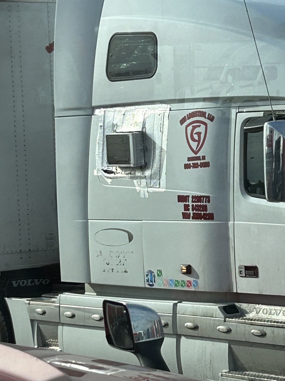

  7. ducnut
    ducnut Road Train Member
    2,683
    8,131
    Dec 31, 2010
    SPI
    Ask and ye’ shall receive. ;)
    Was just reading this thread and this dude was pulling in. What timing. Haha.
    Siinman and Jubal Early Times Thank this.
