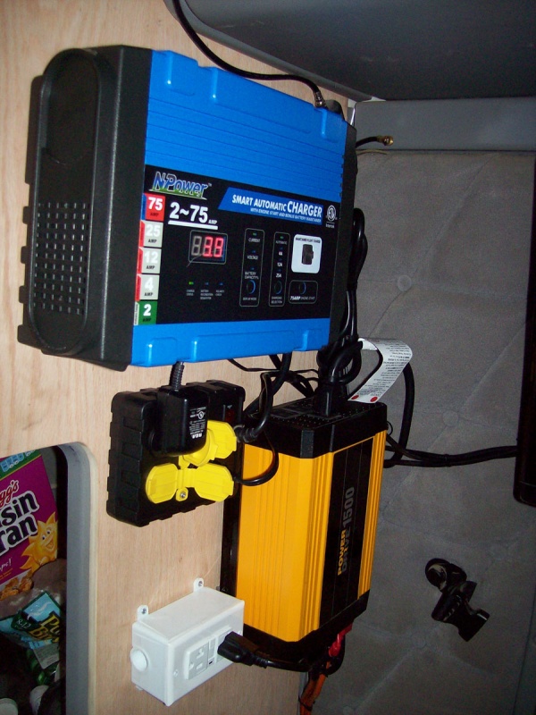

    I'm interested in that battery charger.. what kind is it, how many amps and where did you get it ? I saw some marine units at a Cobela's that were waterproof that were reasonably priced, but that is all I'm needing to do now.

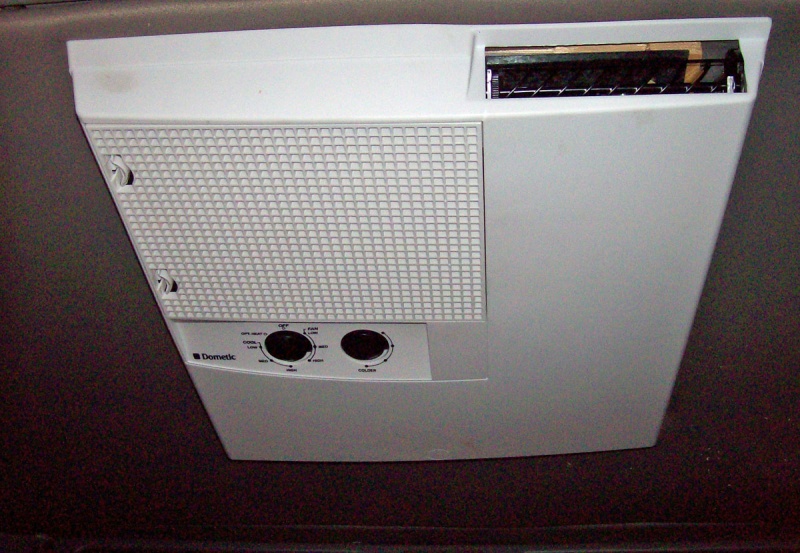

    Point of no return....There is now a 14 1/4" x 14 1/4" hole in my roof!
    Dometic gave me a partial refund instead of me waiting until NEXT WEEK for a new unit!
    Pics to follow....

    As promised....
    Marks for cutting.
    Big hole!
    top unit in place.
    All done and blowing cold air.
    Adapter cord to use the ac from an extension/shore power
    All plugged into the EU3000
    The conduit from the sleeper to the generator.
    Looks like I may make a plywood surround for between the plastic face and the sleeper roof, will see how it does. I also had to slip 1" of plywood where the expanding foam was. The foam was crushing before the gasket/seal on the top unit was.
    Will probably also make some angled aluminum pieces to direct the air flow lower down from the output vents.
    Martin
