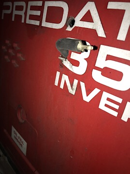

    First things first, remove the spark plug from that thing and replace it with an NGK BPR6ES.
    Then, remove the charcoal canister and chuck it in the trash. The hose that goes to the air filter can be folded in half and zip tied shut.
    Drill a half inch hole through the middle of the "3" in 3500 and stick the other hose that vents the fuel tank through it. Then use a vacumn fitting that goes from 3/16 to 1/8 in the end of it to help keep water and dirt out.
    If you don't do this, the first time you overfill the gas tank, it will flood that canister and cause it to black smoke and run like crap.
    Then you're going to want to install an exhaust pipe so you don't kill yourself or your neighbors.
    Remove the plastic panel off the exhaust side along with the spark arrestor. Connect an Espar heater pipe, available at any Thermo King dealer. Connect that to a length of 3/4" steel conduit and run it right alongside your exhaust stack. Use hose clamps to attach it and Permatex Ultra Copper to seal the connections.
