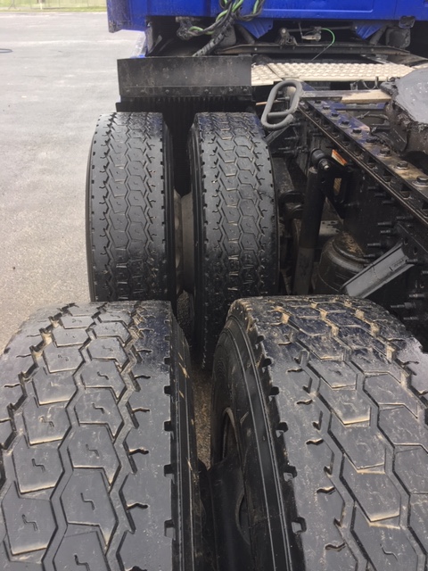

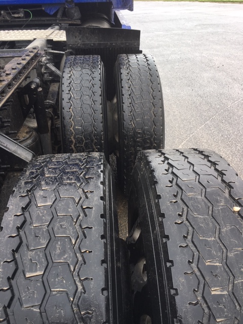

    purchased a truck awhile back, and it had a new set of Triangle drive tires. I was intending to pull these off
    in a couple of months and replace them, so they never got rotated. Got side tracked on other things and forgot to replace them. As of this morning, I now have 347,313 miles on these tires. Tread depth on all four are close to equal. Tires have no cups or uneven wear. I never would have thought these tires would last.

    Tires look good overall, but I’d keep an eye on the inner rear left side. It looks like it’s showing signs of over-inflation, or maybe it’s just the angle the pictures were taken.
    Road*Runner and 650cat425 Thank this.

    Must be the angle or lighting. Replacing them all Monday, hoping to get a little trade-in money for
    them.

    The trade-in money ain’t worth it. They look good for another 6-12 months.

    Road*runner;
    Those tires look impressive, very smooth and even.
