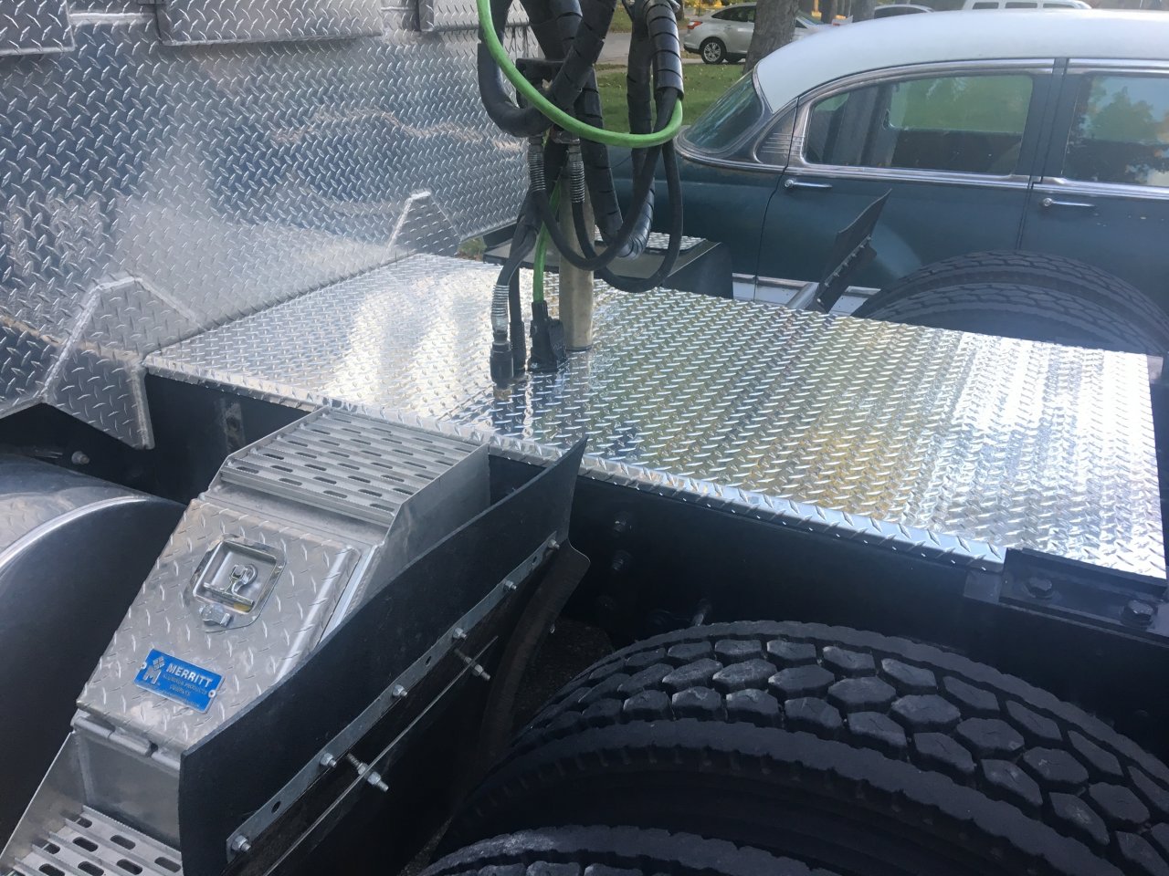

    Run a t off the protection valve to Both locations, put the same quick connects so you only need one set of air lines, get a set of glad hands for double trailers with the shut off valve for both locations,

    get a set of the blank glad-hand stoppers like the wiggle wagons have to keep dirt and crap out of the ones not in use.

    I can't remember the name of those little peices. But I carry spares. When the line breaks in the winter. I take it apart. Cut off 1/8 inch is all that's needed. Put back together with a new peice.
    Those little brass O rings that slide over the air line. And cinch the line in place when threading back together. I think they're called ferrels.

    Mainly I want the lines off my catwalk when I’m dragging chains around, and such.

    Another alternative. Run your airlines out of you catwalk. I find they are not nearly as in the way when getting stuff out of the headache rack.
