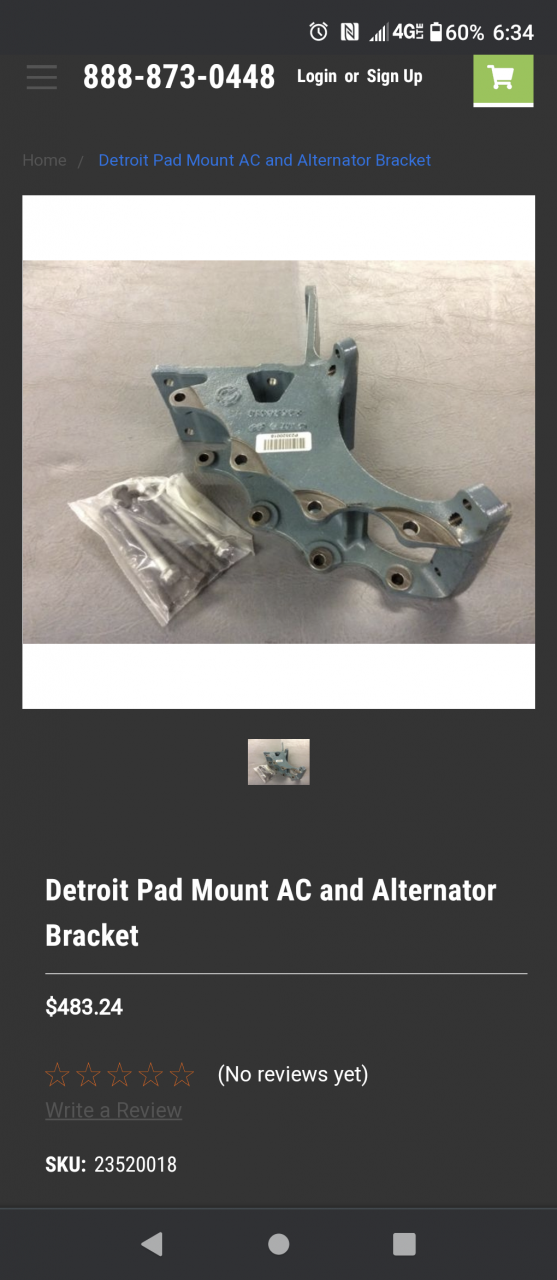

    Hey is this the bracket your talking about?
  8. Rideandrepair
    17,584
    56,957
    Aug 8, 2015
    That’s it. You can find it aftermarket on eBay a lot cheaper.
