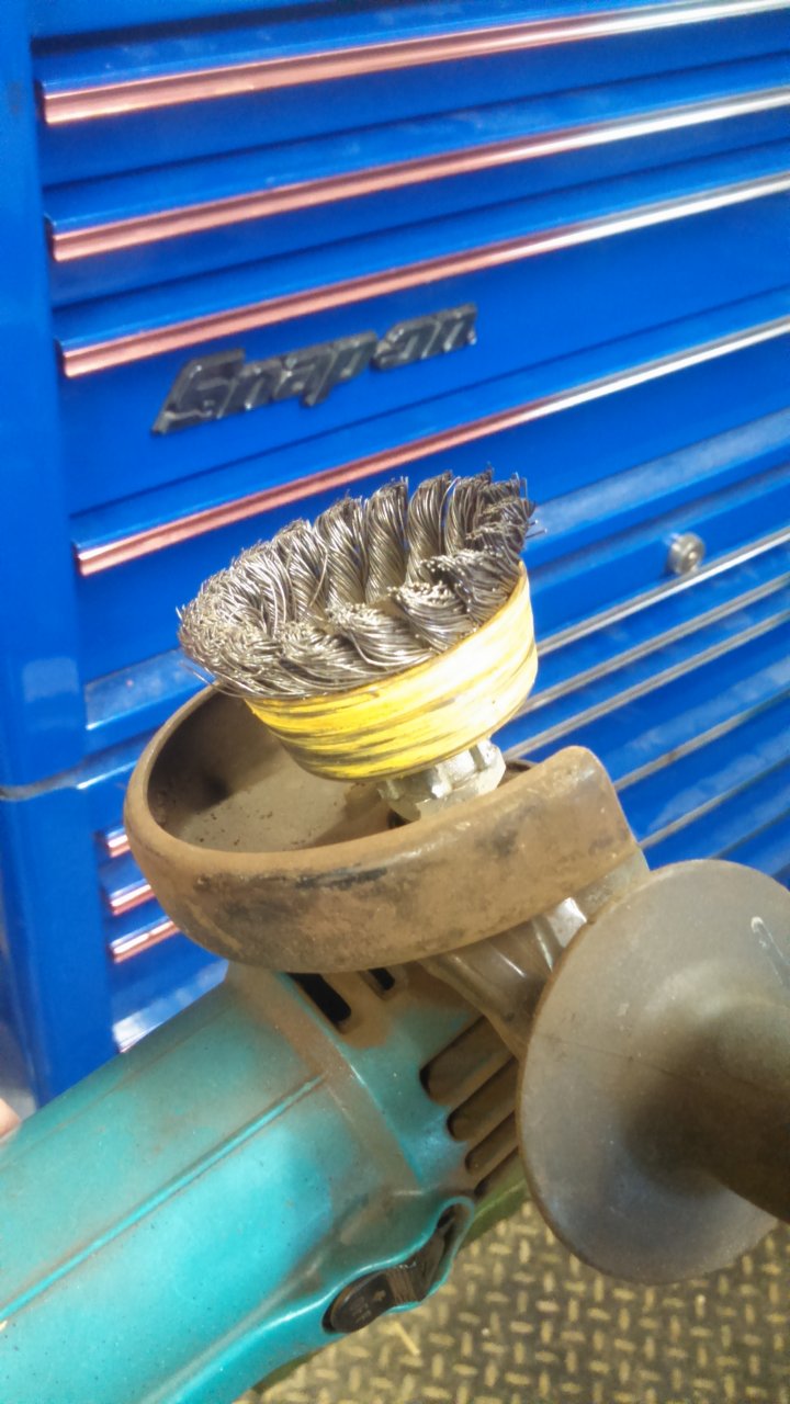

    I've been thinking about getting a needle scaler. What brand do you have?

    I have an old grinder just like that. Its a Makita. I have both that style wire wheel as well as some of the newer plastic coated wires with the carbon ends. I've used them on some older pickup truck frames that I was restoring and they do really well.

    I use a wire wheel like what MJ posted. Then spray some Rustoleum primer, and then paint. Lasts longer than what the oems do, which is no primer.
