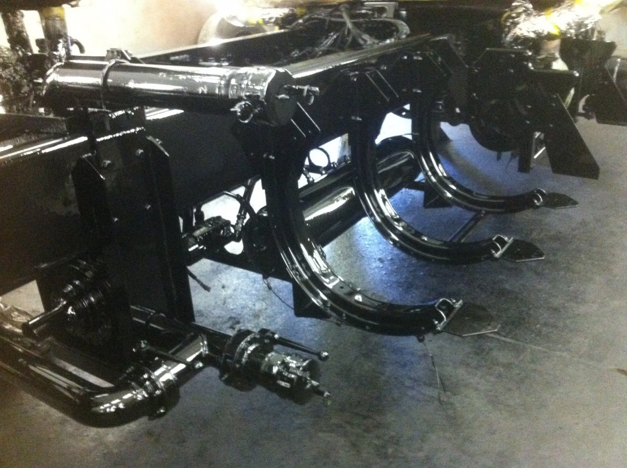

    People can say what they want. I paid my dues to get where I am now. Still working my tail off to to meet goals I have set.

    @Hurst , looks good it will be interesting to see how long your fix lasts....
    And don't feel bad , kw does the worst job painting frames. It's a joke

    Here was my answer. Sand blast and paint the frame stem to stern.....

    Nice job!
    I dont know if I'll go to that extreme on mine. But I'll be very close to that when I get back off the road next Sept/Oct.
    I dont have an impact gun large enough to take my wheels off yet. Will pick one up when I get back. I do plan to strip the rear half of the frame,.. just leaving the suspension and axles in place. Everything else that can unbolt will come off. After I strip it down to bare metal it will give me a chance to run some new air lines and rewire the back half of the truck. Plus I've been wanting to replace the plastic half fenders with something else for a long while now.
    Not sure if I will drop my fuel tanks or not. The rust wasnt too bad up under the sleeper and cab. Just mainly from about the fuel tanks back is where it turned ugly. Under the hood and cab still look almost new. That and I dont have the tools or facility to really go that in depth with it.
    I cant even really park my truck at my place yet. The ground is too soft to take it off the driveway and there is no way to turn it around with out gouging up the property. My wife would kill me. I've been trying to get the money together to repave the place and make a paved turn around area out back were I want to set up an out building/repair shop. All $$$$ that I just cant spare right now. The place where I park my truck is huge. The property owner lets me do anything I want there. Its an old concrete plant. Its just a hassle dragging all my tools and compressor out there all the time.
    I'll get it done right. What I did now is just temporary to get me through the summer months. I'll probably take a few weeks off in Oct to focus on getting the truck ready for the winter season.

    Used Chasis Saver on my 55 Chevy truck frame, set outside for 3 yrs and still looked good, not in salt and rain neither though.
    Brush real good and paint.

    Ospho. You can get it at NAPA. Brush on rinse off. Knock of flaking rust. And reapply. Works as a neutralizer and primer. You can use spray paint over it. I use John Deere gloss black implement paint. You can brush it or spray it. I use a cheap primer gun and spray it. Tough as nails.
