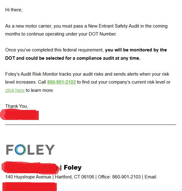

    One thing I've learned since getting my DOT number is how many 3rd party compliance companies come out of the woodwork, most of them being scams. Typically, they're easy to spot. However, these guys at Foley keep emailing and calling non-stop. I haven't answered them once or responded to any of their emails. Yet, they continue to pester me. Points for persistence, I suppose.
    Anyway... Is a safety audit a real thing that the DOT or FMCSA require or is this just another scare tactic to try and get me to call them? My DOT number is set up as intrastate so I'm not crossing state lines and I'm not running outside of 150 air miles so ELD's don't apply to me, either. Don't know if any of those things are pertinent to whether or not a safety audit is required.
    If it really is a requirement, surely there's a way to do it on your own without a 3rd party getting involved, right? Thus far I haven't needed one and would really prefer to not pay someone to do something I'm totally capable of doing on my own.

    Anything from Foley is a scam.......

    Look, next time Foley calls answer the phone and calmly ask them to put you on their do not call list and ask to be taken off their mailing list.
    I actually used them in the beginning to help me create a legit driver file. They treated me well and I can’t say anything bad about them. For me they were easy to deal with and communicated well. Once I got what I needed I canceled the service. Never once did they pressure me into staying. Canceling was easy and pleasant.
    Nebraska will give you a safety audit within 12 months for intrastate. It’s really not a big deal and will probably just be a document exchange via email. Make sure you are enrolled in a drug testing program and have your clearinghouse setup.
    I’m interstate out of Florida and had my safety audit within 6 months I think. Mine was handled by the Florida Highway Patrol. Was initially contacted by phone and then everything was done via email. Was a big document dump for me. They can do the audit in person so just be aware. Typically they save the in person visits for carriers that are having trouble with violations imo.
    You don’t need a third party to set you up unless you’re totally clueless. I was clueless about the driver file so that’s why I paid Foley to set it up. Once I saw it I realized how easy it was to do myself.

    Yeah, its a real thing. Like some of the other guys here, I too was naive about the administrative rules and what to expect. I didn't hire anybody to do any prep work. I got the little green book down and went through what was required. Some of which is trivial, depending on the personality of the auditor.
    I had a lady that come did my DOT audit. I was based in Louisiana. She mainly just wanted to make sure that I was generally in compliance. If something was wrong or not in order, or not in place, she just said you need to get this in order and that was the end of it. She didn't write any citations or anything of what they are allowed to do. She just explained that It wasn't done or wasn't in compliance and explained how I should go about doing it.
    It's just a bunch of administrative stuff that company drivers dont ever have to deal with and don't know about.
    You gotta have a file for each employee.... including yourself. You gotta have a safety person.... which was my wife. It can actually be you... you just gotta have a safety person named etc, etc.. It's just trivial stuff mostly.
    She wanted to look at my log books and fuel tickets etc. I think some BOLs etc. Again, trivial stuff.
    I think she had pulled my DOT record etc.
    Again, I just read through the green book that outlines the admin stuff and just kinda winged it.
    Thats was pretty much my experience.
