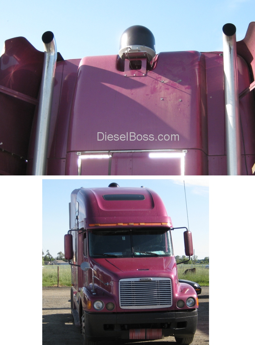

Here is the scoop. There were 2 styles of QualComm units (older - larger and newer - smaller)
But the answer to your question is the same regardless. The bolt pattern on the TV satellite current models (King and Winegard) are in an 8" X 8" square pattern. That is NOT the same bolt pattern as any QualComm.
In order to re-purpose a QualComm bracket for satellite TV you need to just fabricate a plate. We use aluminum, but I suppose a guy could make it out of just about anything. You bolt the plate to the exiting QualComm Mount and bolt the satellite to the plate that you made. Click the pic below for example.
That isn't the real challenge. The REAL problem tends to be that once you put something that is 14" inches tall on top of the QualComm bracket you go over 13'6" height unless you have a mid-roof or lower truck height to begin with.albert l, flood, x1Heavy and 1 other person Thank this. -
