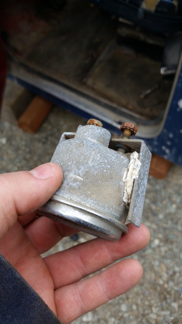

    Back at it again today. Got tired of playing with the torch so I'm continuing with gutting the cab. I'm finding some pretty interesting fixes for wiring such as this foil from a cigarette package used to help ground the pyro :biggrin_25523: 20160408_140903.jpg

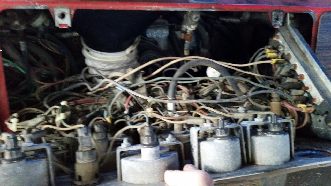

  8. AModelCat
    29,769
    165,455
    Yuk! What a mess! I'm amazed the 2 hours total time I had this truck running didn't reduce it to ashes. I've counted at least a dozen of those cheap scotch lock connectors and a bunch of terminated wires. Thinking I'm probably going to upgrade the wiring while I'm here since I'm pretty sure the cab and chassis wiring harnesses have been out of production for at least a decade or 2.

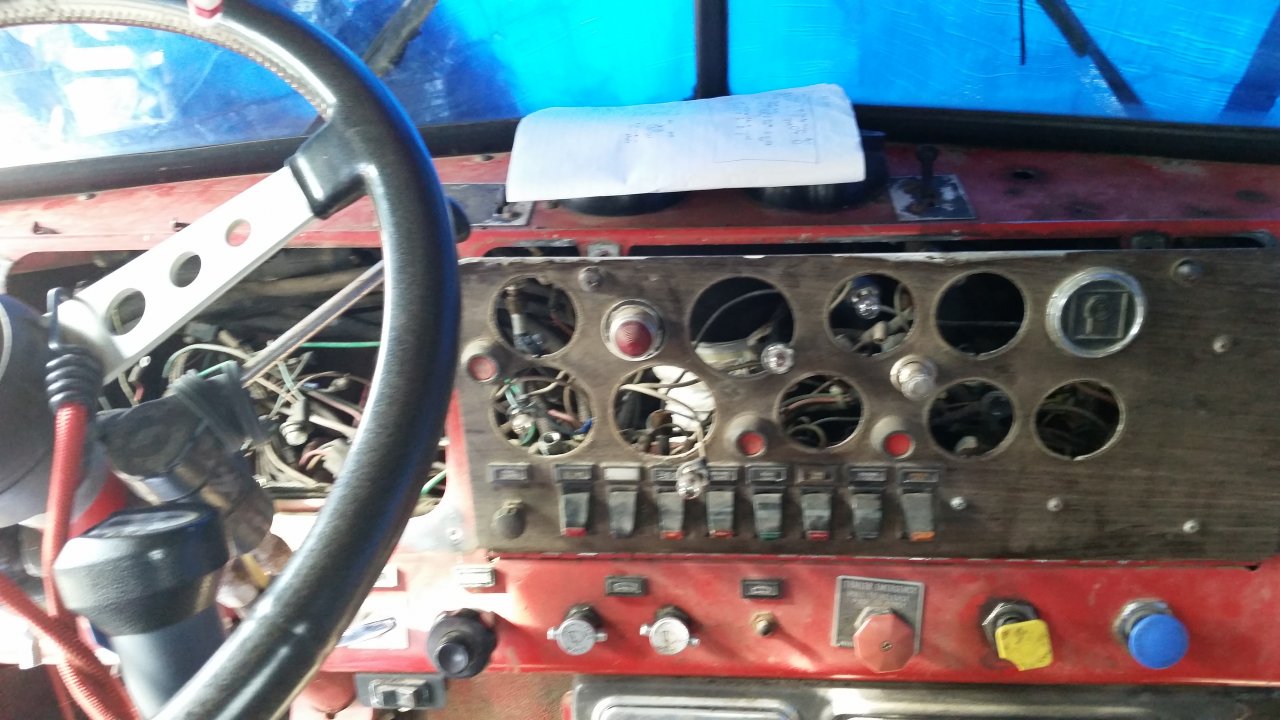

  11. AModelCat
    29,769
    165,455
    I think this is it for today. Only crappy thing is I'm going to have to build new dash panels. The previous owners have butchered up the dash pretty good for extra switches and such.
