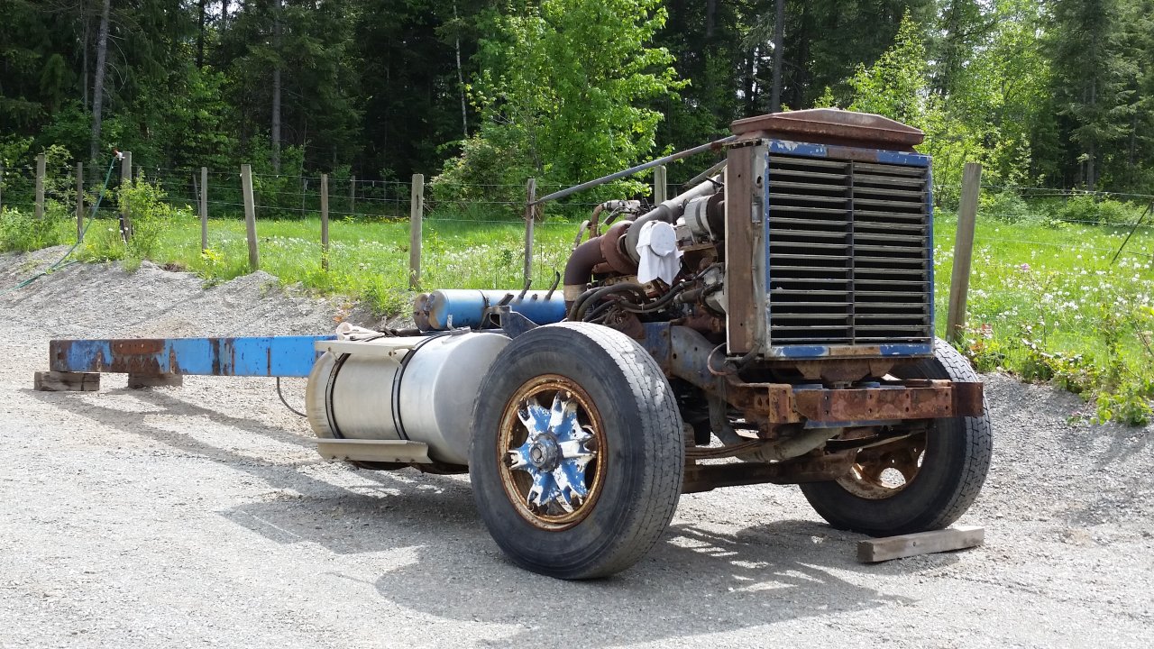

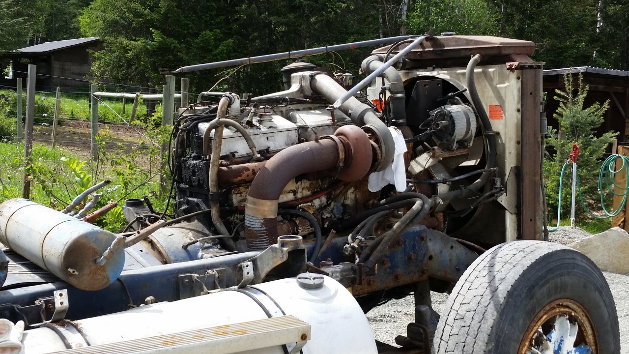

  4. AModelCat
    29,723
    165,039
    Got her all dug out. Killed 4 wasp nests. 1 on the rad, 3 on the cab.

  11. AModelCat
    29,723
    165,039
    Did a little more steam cleaning on the engine and around the front end. The grease and oil left now is so caked on its going to have to be sandblasted off. Even degreaser didn't do too much. Also steam cleaned the firewall off as well. Found a lot of the brackets and piping on the engine is aluminum so I forsee many hours of polishing in the future ;)
