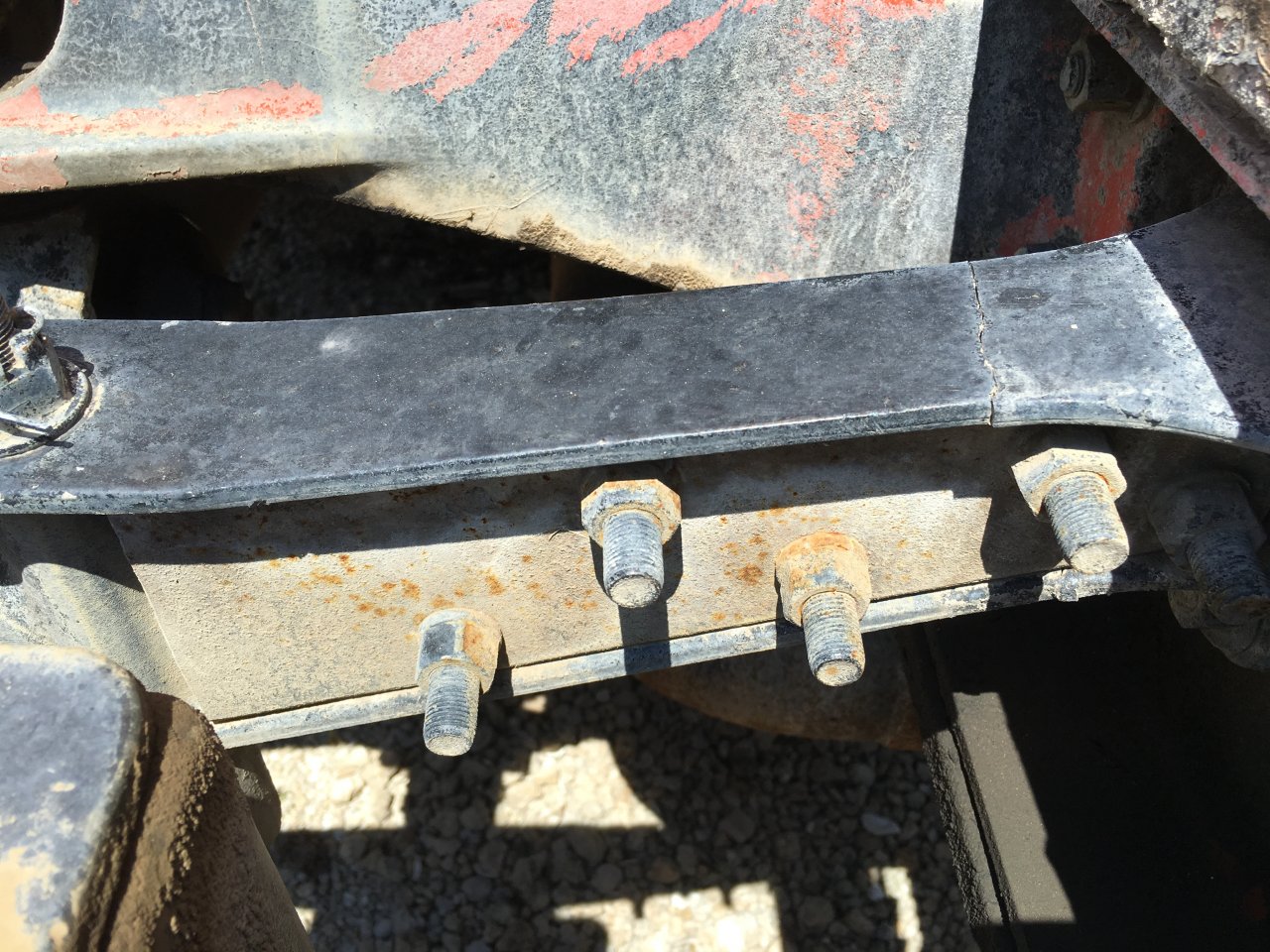

    You are not alone!! I just found this

    What's that part? Trying to picture what it is.

    Is that part of the suspension? I see the pad.

    That is a broken cross member that has the carrier bearing for the auxiliary transmission it has been sandwiched between to 1/4 in steel plates and bolted. IMG_0973.JPG

    They did the other side too, 5 pounds of prevention I guess.
    The point was there is no end to what we will find.
