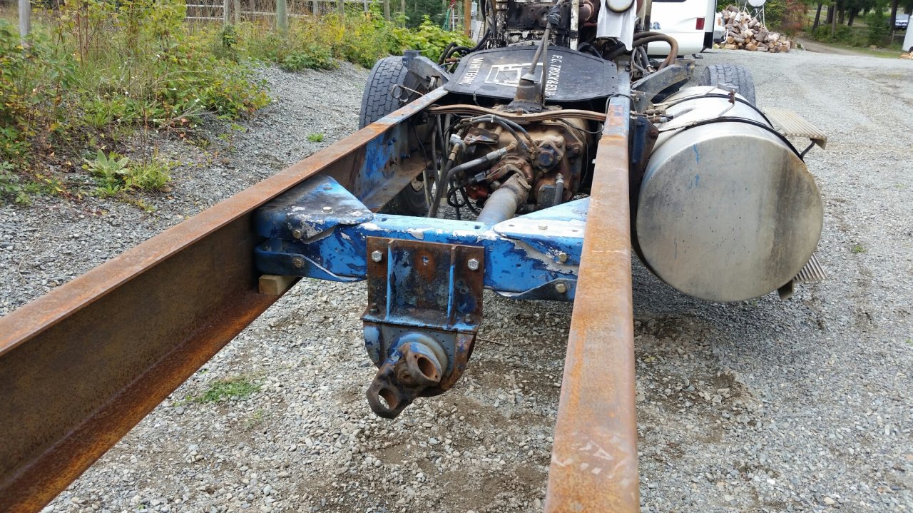

    Mocking up and installing the first crossmember. Also trimmed up my 10' sleeve into 5' ones for each side. 2016-09-10 14.54.21.jpg

    Well I just noticed I have the lower gussets upside down. I just assumed the last owner butchered it together but a quick Google search shows they need to be flipped over. Glad I haven't drilled the holes yet. :)

    Is it just me or does it look crooked?

    The rail? I ran a string down the side of it and its pretty close. Could just be the blending where the 2 rails meet.
