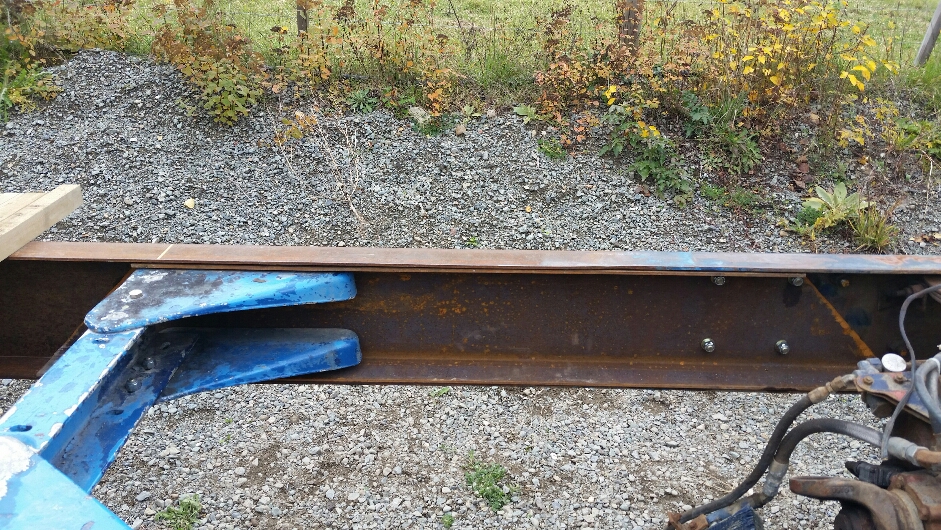

    Got these drilled and installed. Still need to drill holes for the air drier and tanks once I start to piece it back together.

  6. TROOPER to TRUCKER
    TROOPER to TRUCKER Anything Is Possible
    7,679
    12,758
    Dec 15, 2014
    Charlotte, NC
    Wish I knew enough to do something similar.
  7. AModelCat
    29,778
    165,576
    Its been a process that's for sure.
