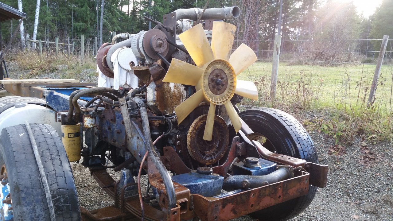

    BAM!!!! Look at that!
    And the rad's gone too!
