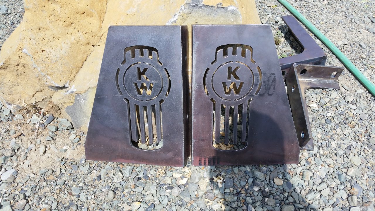

    Check these out! Wanted to keep them under wraps until later but its all over Facebook now so what the hell. Just picked them up and I'm extremely impressed with these. They are the rear cab mount brackets that bolt to the frame and support the cab crossmember. 20170713_133921.jpg

  9. dngrous_dime
    dngrous_dime Road Train Member
    3,150
    5,765
    Jan 28, 2014
    Lansing area, MI
    Needs powdercoat. Me likey.

  10. AModelCat
    29,724
    165,061
    They're getting primed and painted tonight, along with a crap ton of other parts I picked up from the sandblaster today.
