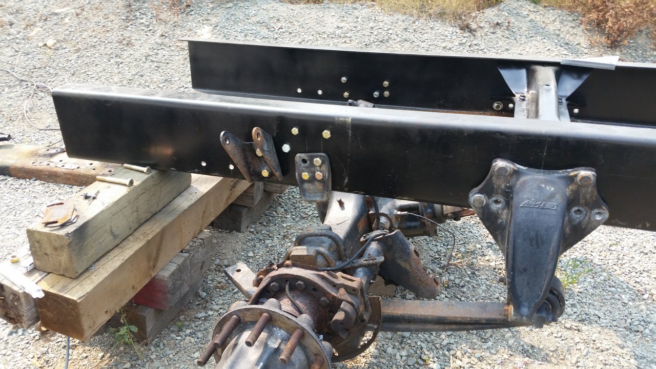

    Up at the ###crack of dawn today. Hot wrenching the last few parts from the donor snip. About two dozen holes left to punch in the truck frame and the structural part of the ### end will be together.

    Measure, measure, measure! And when you've got it, measure 2x more! Just about punched the holes for my upper shock mount an inch too far back lol.

    Got rained out before I could mock up the rearmost crossmember. Got all the suspension holes drilled on both sides though. Also managed to install the forwardmost crossmember and inserts.

    How do you drill those holes?
  9. AModelCat
    29,783
    165,638
    Pilot drilled them with a small bit and then put a reamer through each pilot hole.
