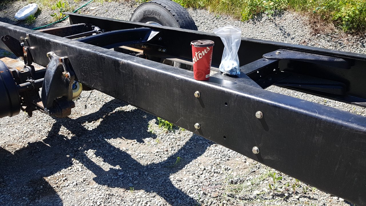

    Working away putting all the missing hardware into the frame. Originally just put everything together loose with a couple bolts in each part to hold it all together.
