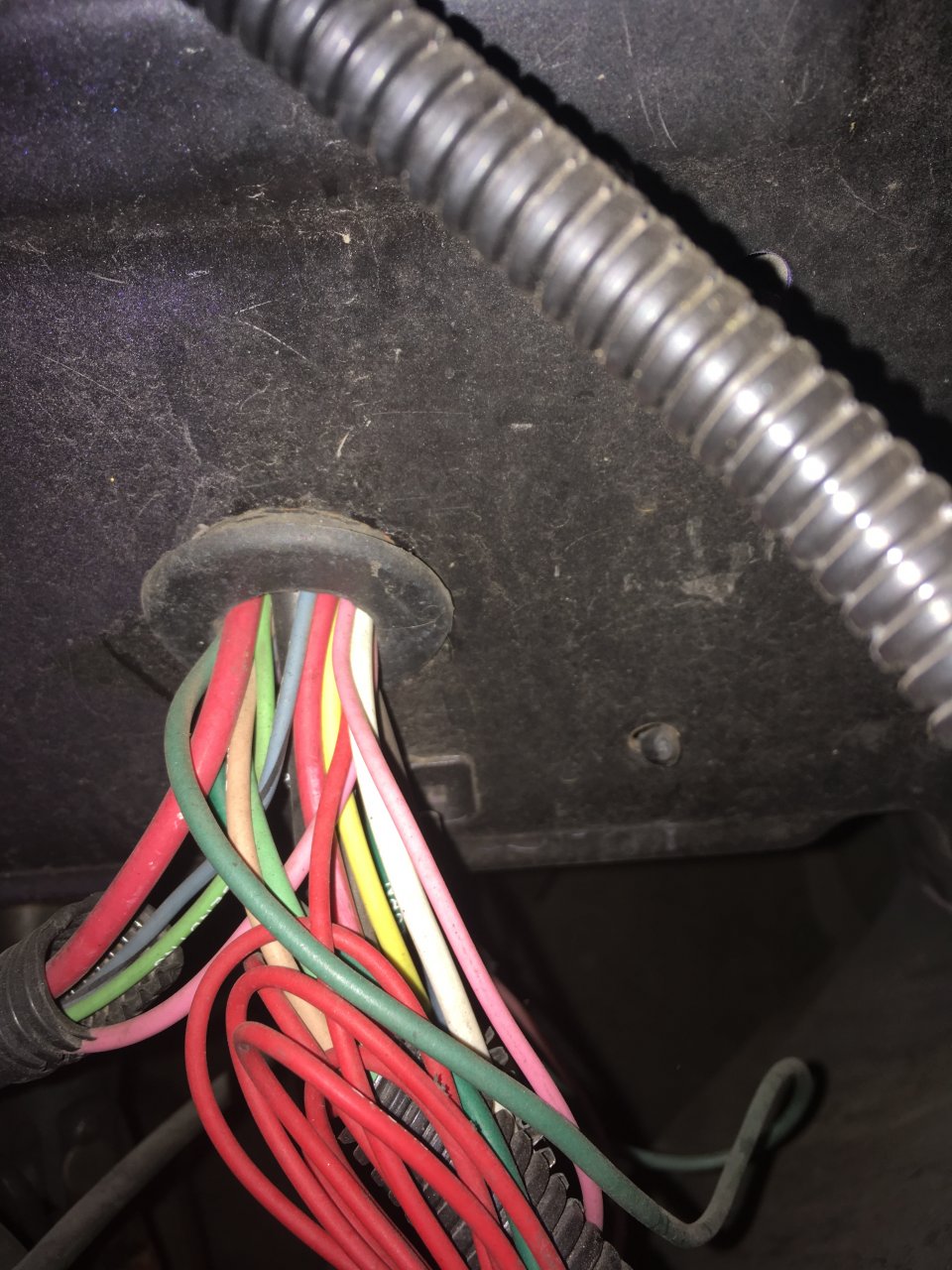

    I like everything neat and clean. I'm actually looking into putting a bulkhead plate inside the left frame rail, behind the cab. That way I can wire and plumb the entire back end of the truck and do the cab seperately. Then just trim up the airlines/wiring and just plug them in to the back end once the cab goes on. I'm all about doing everything easy and simple lol.

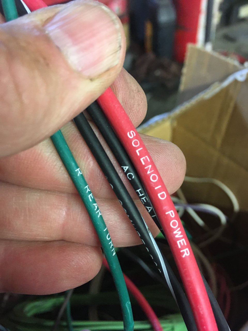

    C2351E25-13B1-43C8-B4F5-1BBCF1C1FD46.jpeg I like all my wiring labelled:)

    I'm likely going to update to a modern relay and fuse panel. I'm thinking I'll colour code everything in the dash though and I'm actually working on sketching out a wiring schematic for how I want to wire the truck.
    Tug Toy, Feedman, Oxbow and 2 others Thank this.

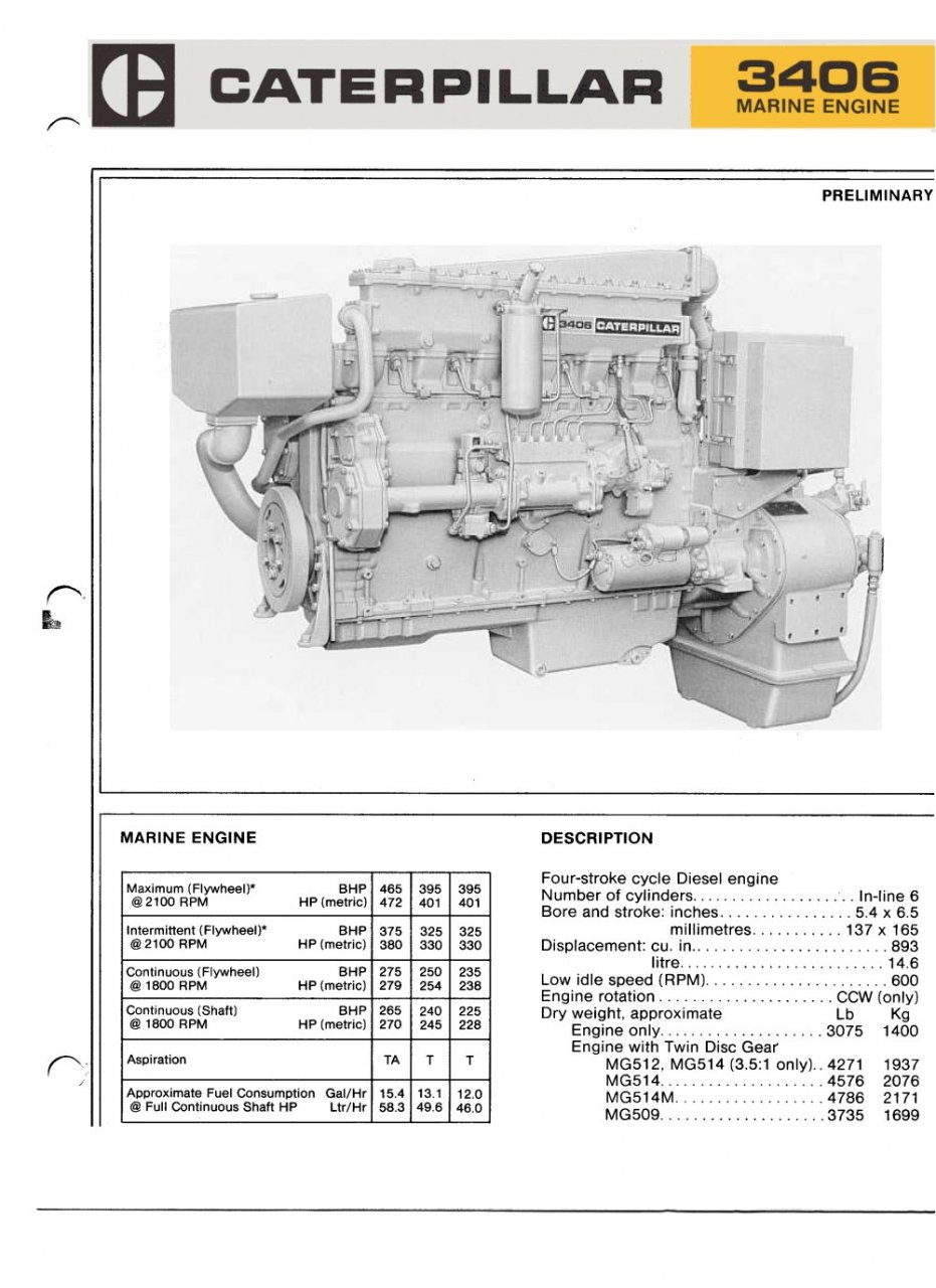

    Anybody know what I'd need to do to get these numbers? 465 would make this truck a rocket.

    I'm gonna bet camshaft, nozzles and timing. With the turbo options of today you may do a little better

    Not really wanting to spend big bucks to get there but if my cam is shot I think that'd be a real possibility. It'll be getting new injectors and possibly a new turbo though.
