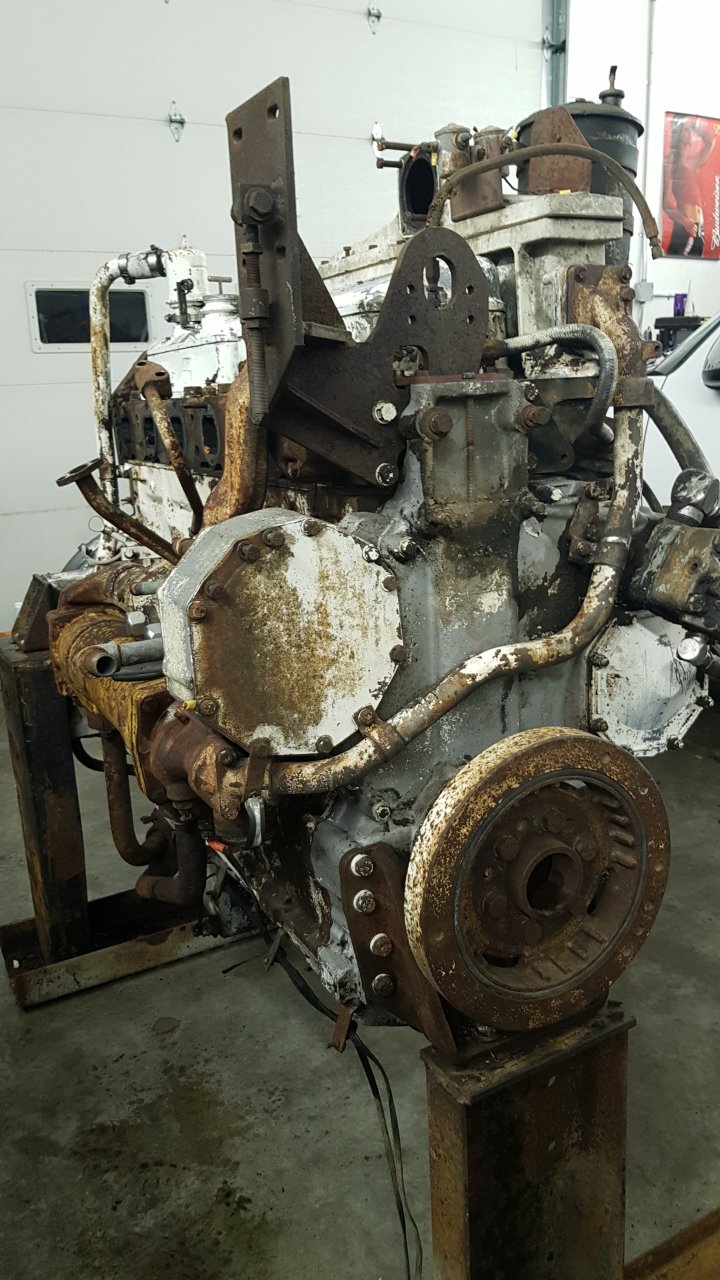

    Its on a stand. Bungies are holding the tarp down on it. Haven't got it in the shop yet.

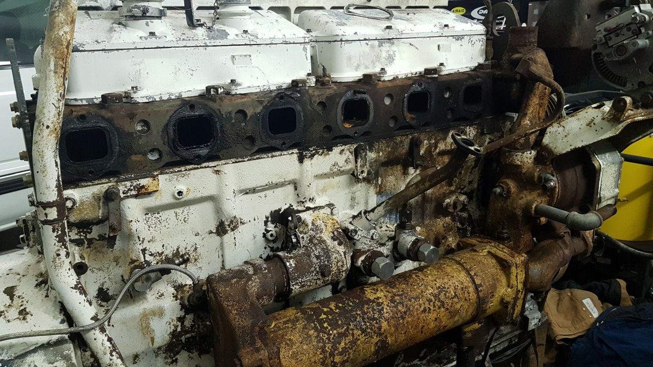

    Suprisingly enough all but 1 stud came out like butter. The bad news: All 4 studs on cylinders 1 and 2 are actually broken, not just missing :(. 20181014_194449.jpg

  6. sdaniel
    sdaniel Road Train Member
    5,511
    4,420
    Sep 7, 2011
    Pelham N.C.
    Looks like there is enough to weld the inside of a nut to the end . Once they go through a heat , they will back out . Drilling for a ez out is for the hard ones.
    Tug Toy, wore out and Feedman Thank this.
  7. AModelCat
    29,771
    165,472
    Not going to worry about them yet. I'm going to get the head off first and see if its any good first. If its cracked or needs to be replaced CAT can worry about it when they reman it.

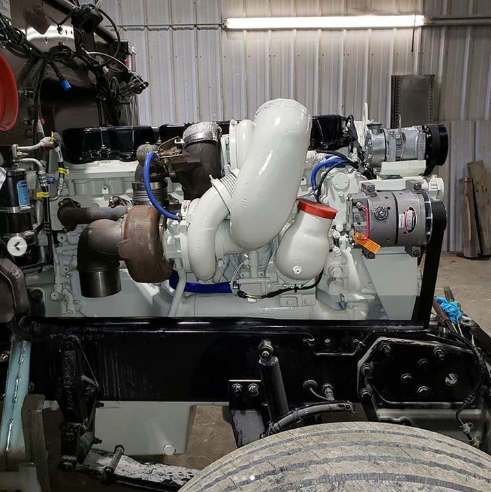

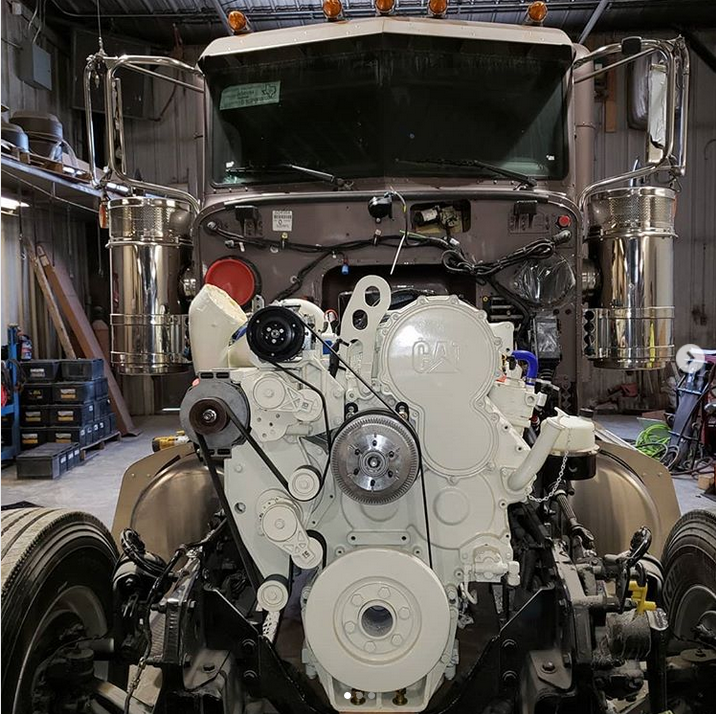

    Tug Toy, NightWind, Bean Jr. and 4 others Thank this.
  10. AModelCat
    29,771
    165,472
    That is purty
    Tug Toy and Bean Jr. Thank this.
