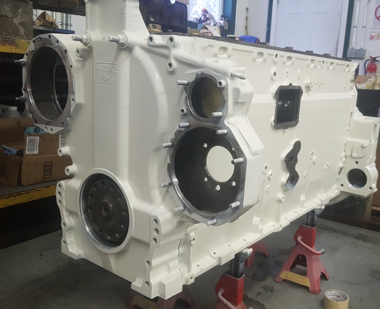

    No updates doesn't neccessarily mean no progress. Block, crank and cam checked out. Most all bottom end parts are on order. Crank has never been ground, main bores never machined and the bore is still aligned. Hot tanked/crack checked. Couple thou shaved off the deck to clean up some minor pitting. New frost plugs in the block, all 6 liner seal bores cut/sleeved. New cam bearings installed. Dressed up in CAT Power Module White. 20191020_122745.jpg

    Looking good, Cat marine white was definitely the way to go.

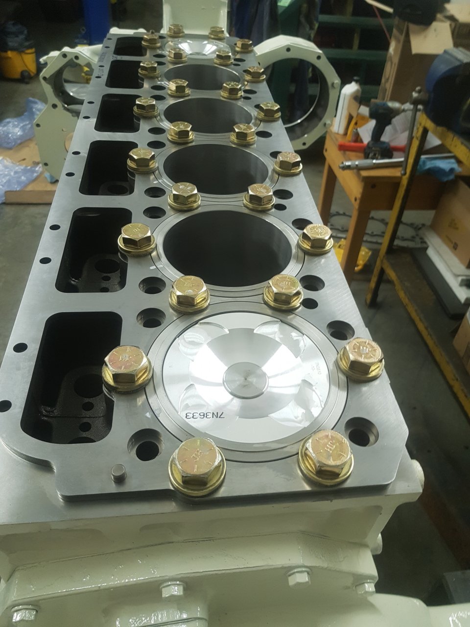

    Cause I should probably update this once in a while: 20200131_175354.jpg

    Looks Real Good..Why do u have those bolts on top of Block ?
  9. AModelCat
    29,766
    165,402
    There's a steel plate called a spacer plate that sits on top of the block deck. The bolts are holding it and the liners down. CAT uses a special fibre washer under the bolts so it doesn't damage the liner flange or the spacer plate.
