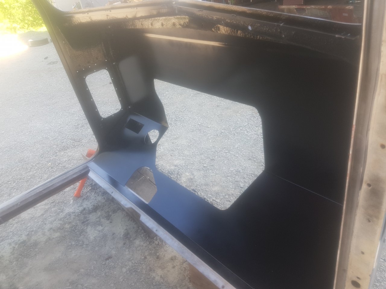

    Good enough for now. Next month we're yanking the rear beam out of the cab. 20210523_114710.jpg

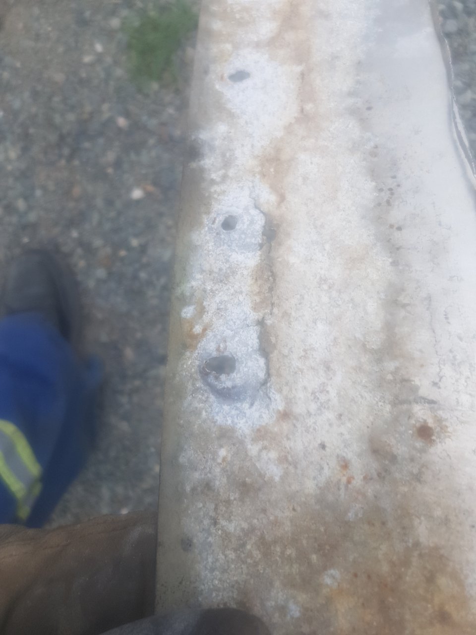

    Well that's out. Bottom 3 inches of the back wall is toast. Just need to fab up a new beam, weld it in and replace the aluminum strip along the back.
    After that its just fixing up the fiberglass roof, put all the huck bolts in and then its time for some bodywork.
