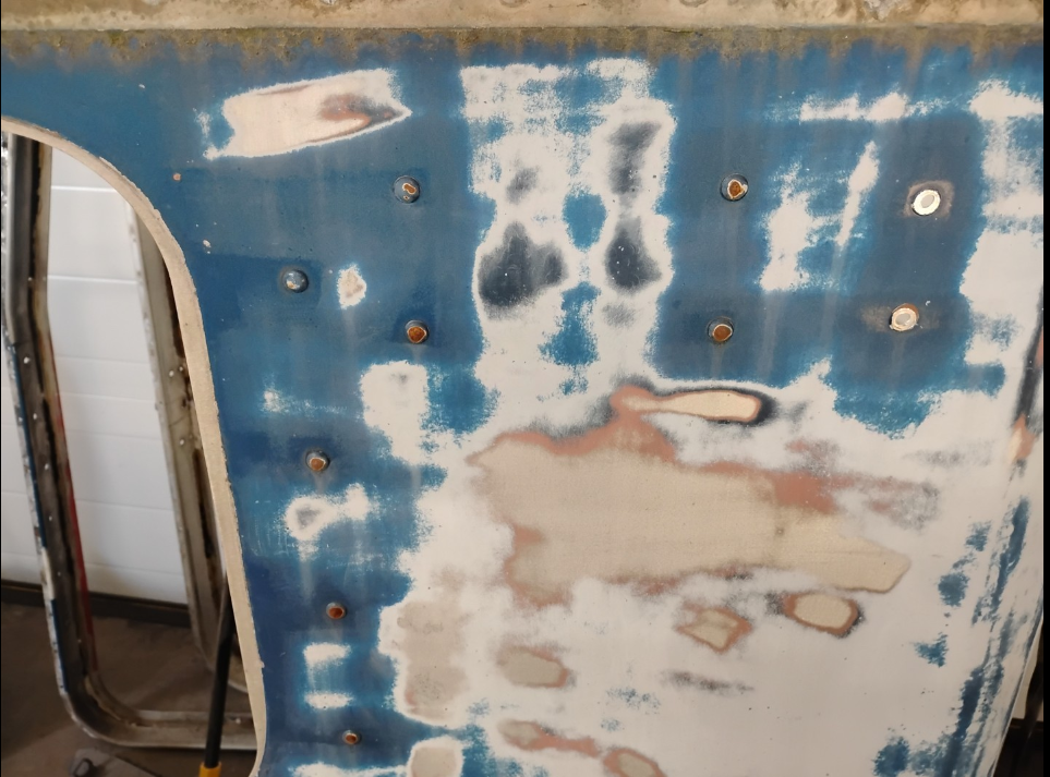

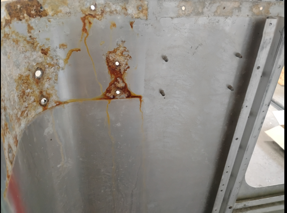

    Any ideas what sort of accessory may have utilized these 4 holes blanked out with the huck bolts? Wondering if KW may have had a behind the cab stack option since only the passenger side has these holes. Screenshot_20260125-144939~2.png Screenshot_20260125-145141~2.png

  10. Oxbow
    Oxbow Road Train Member
    13,728
    142,415
    Nov 24, 2015
    Most likely would be my guess.
    Feedman, RGN, D.Tibbitt and 1 other person Thank this.
