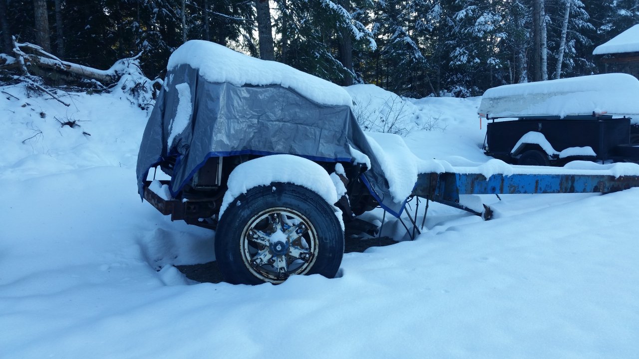

    Well I was thinking about rebuilding and polishing the turbo. The snow changed my mind.

  7. AModelCat
    29,763
    165,375
    Not at all. I'm going to be pulling wrenches in the snow for the next 3 months. Kind of want to avoid it on my time off.
