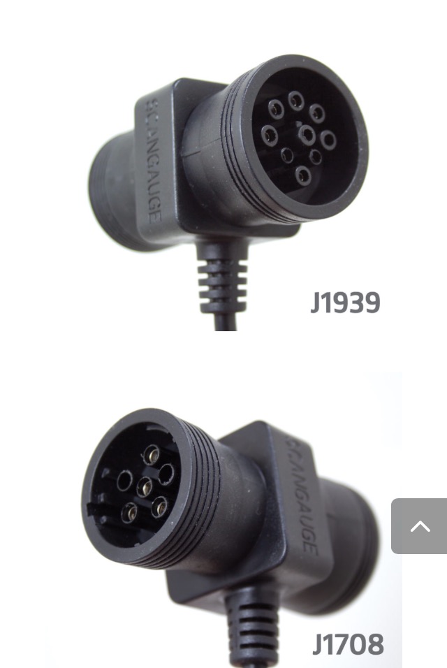

    Ok guys I went out to one of my trucks and dug out the owners manual and it will display the total miles reported by the vehicles ecm. I did not know this so I learned something today.
    So to answer your question @2CAN it can display a odometer reading however, it depends on which port you have. The J1939 9 pin port will display the total miles where the J1708 6 pin port will not.
    Here is a pic of the two ports.
