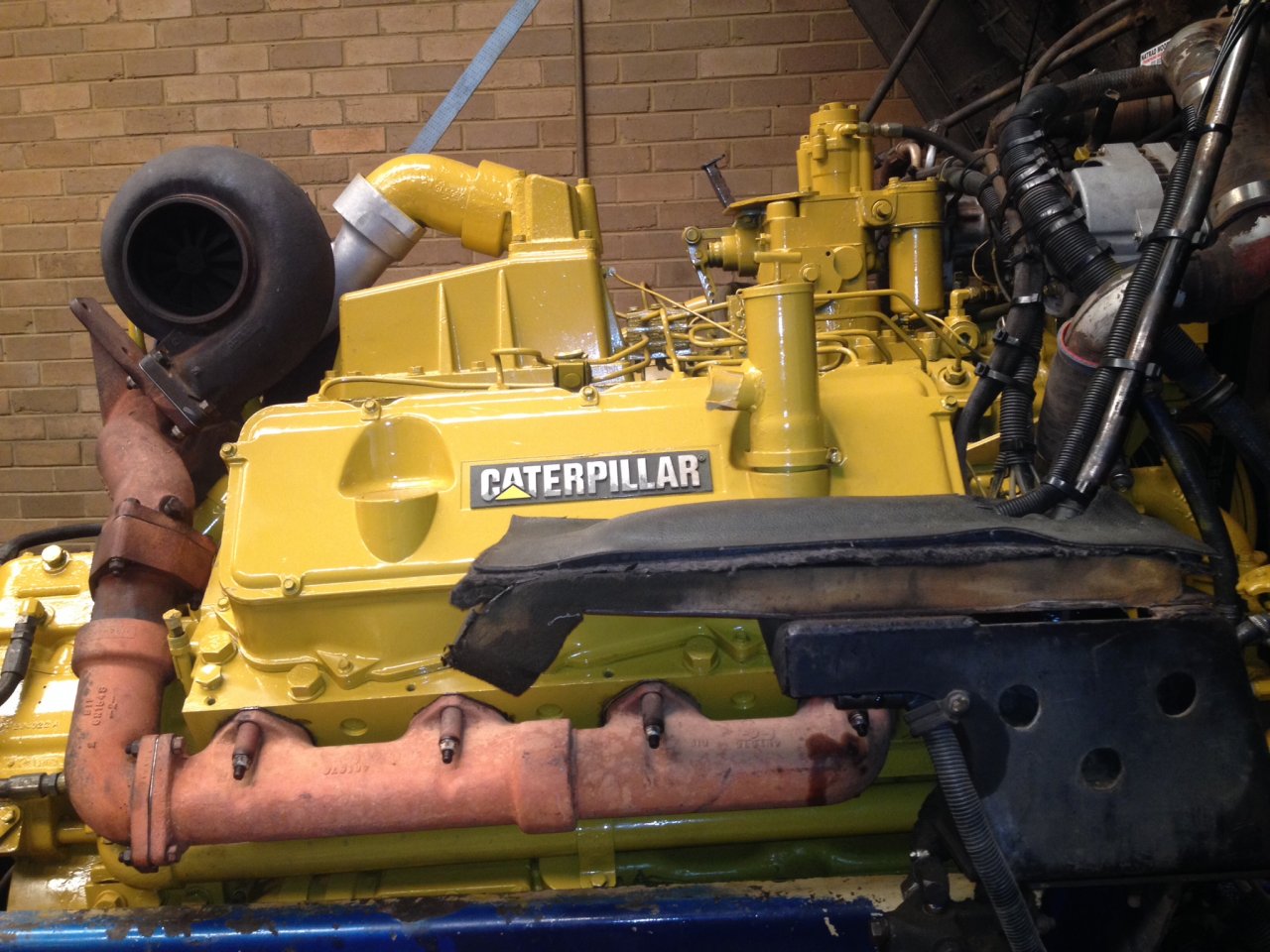

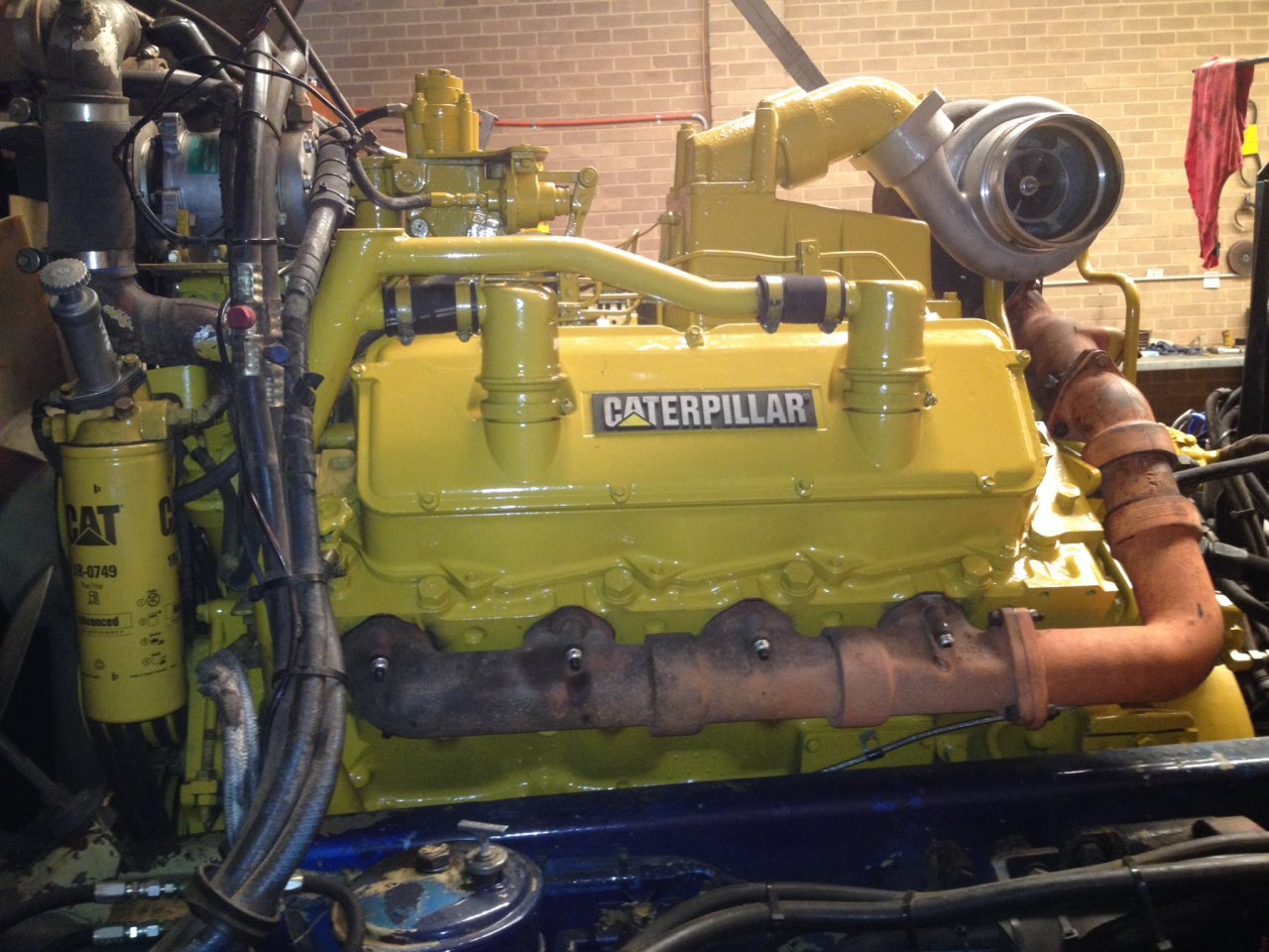

    Here's a couple of pics of my 3408 in my KW cabover when I was doing a major job on it. As you can see the turbo and aftercooler take up a lot of room on top, that's without the intake and exhaust connected.
    The engine is very wide, the exhaust manifolds actually overlap the frame rails. You can see the compressor at the back of the engine in the 2nd pic. It lays over on it's side there's so little room.
