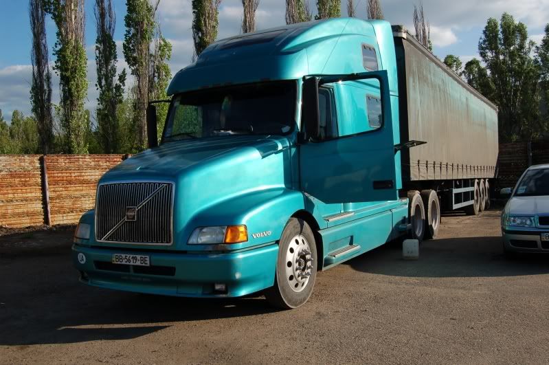

    This is my favorite EU truc with Scmitz trailer
    And this is my friend's truck with N14. Trailer - Schmitz, with EBS, all disk brakes. This is really good combination of EU trailer, designed in Sweeden cabine and legendary reliable N14 Select+.
