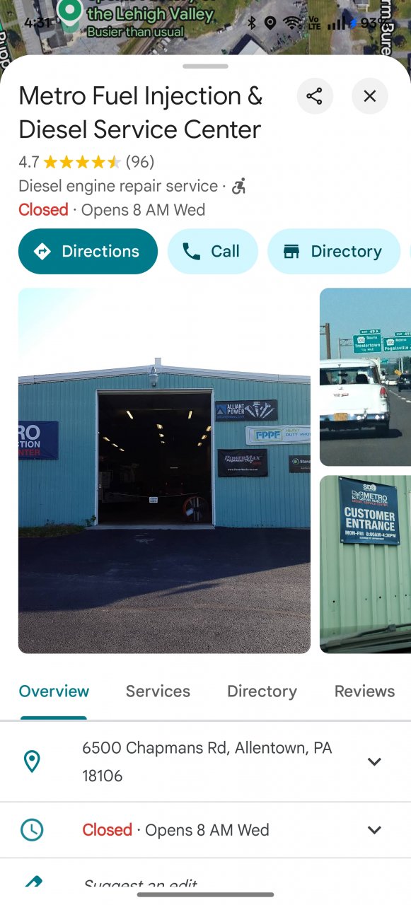

    I had really good luck with Insite diesel from California, but there is a new guy running the shop from last year and I have a hard time communicating with him.
    I will buy from this place next time. Ask for Lenny

    I wouldn’t run anything from metro on a lawn mower never mind something I rely on to make a living with
