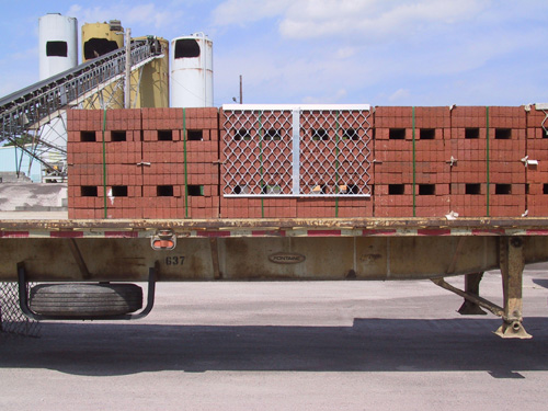

    We always use the plastic snow fence. Its light and easy to bungee together, the bricks will chew up a tarp fast. Two 50' lengths will cover the whole load and keep all the bricks on the trailer.

    View attachment 82249 border mesh Metromont8.JPG www border conceptsyou can make your own with a grinder and small sledge hammer
    ShooterK2 Thanks this.

    i had put a piece of metal under the headache rack from frame rail to frame rail and stacked theme there

    I've done a few loads of the smaller red bricks. They were on pallets and they were stacked so the long sides were on the sides of my trailer. They were banded together using those plastic bands. I used my longer 10" plastic edge protectors and strapped the pallets that way. IIRC it was only 10 or 12 pallets. Thats all I could carry and scale legally.
    Wasnt difficult at all. Of the 3 loads of bricks that I have done,.. I never lost any bricks. Only reason I dont really do them is because they dont pay very well. Was just a load I took to get me where I had another load lined up.

    I was delivering theme steady for a landscaping company and hurst is right they if they are stacked right and banded they really arent hard to deal with. I seen guys take to pieces of plywood connected together with old straps and that worked also
