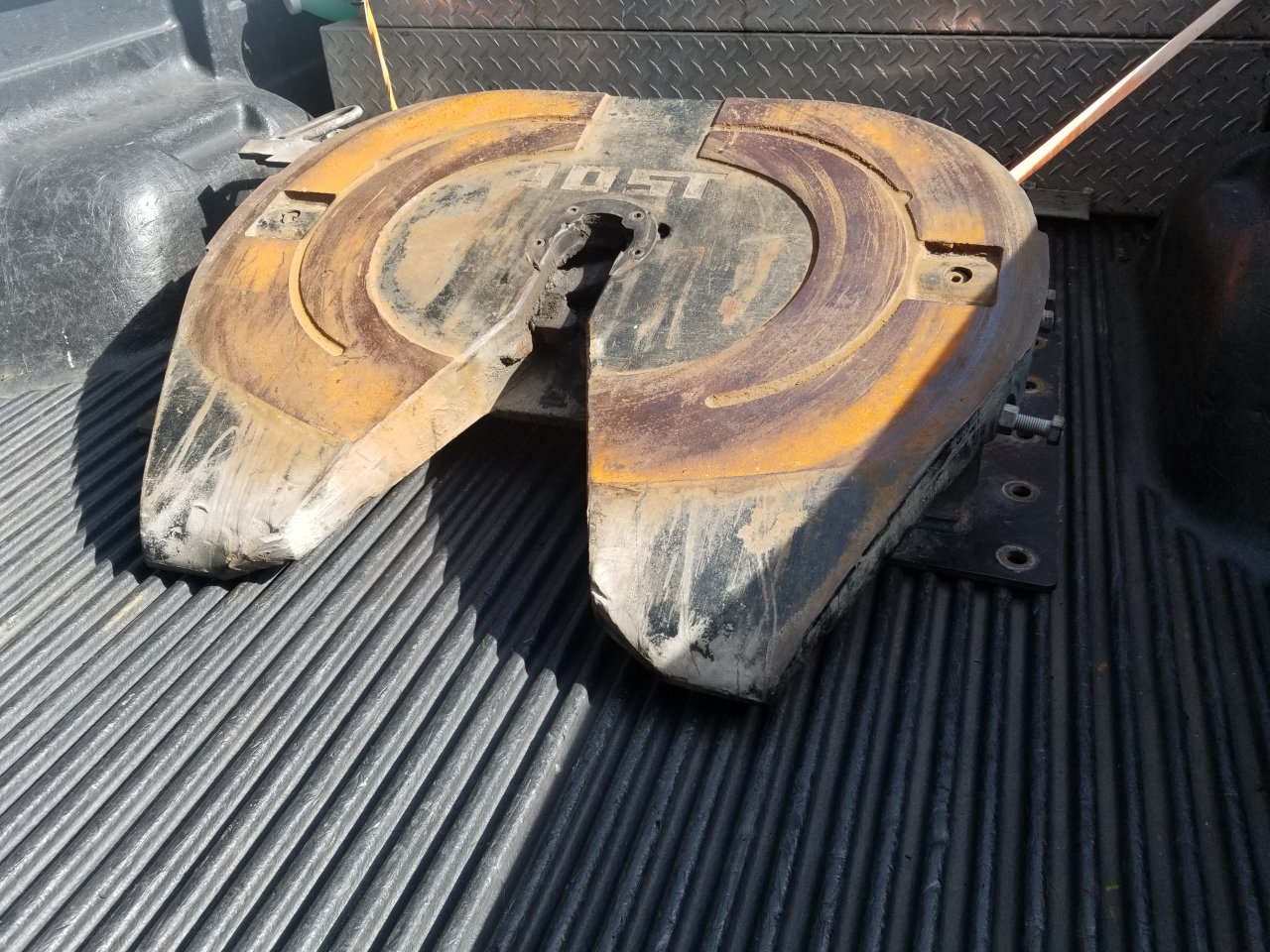

    I found a trailer shop that will do the mods to my flat deck trailer I'm wanting to do (make it a low step-deck).
    I need a heavy haul 5th wheel because the trailer will have a kingpin under it like a semi stepdeck so I was planning to simply use a semi 5th wheel. I came across a good deal on one that has the right width mounting plate so I picked it up but now I'm second-guessing myself..
    Is this thing too big? I know they are big but after getting it in the bed of my other truck I'm like umm yeah that's big and heavy. What do you guys think? Go with the semi 5th wheel or sell it and get one of the flat plate mount 5th wheel for smaller trucks?
    The other option is to go with one of the lighter duty ones like this.
    https://www.amazon.com/Fifth-Wheel-...ywords=5th+wheel+plate&qid=1610305250&sr=8-23
    I need it to be low as possible so I don't want to use the heavy-duty camper style up on risers. It needs to be a flatplate mount

    Keeping the bed on the truck? If so you'll have trouble pulling the 5th wheel release. Just not enough room.
    Also, it will likely cost as much to fabricate a mount as to just find a 5th wheel for your application.

    It's going on a different truck. I have a F550 cab & chassis. I simply picked it up in my other truck. I'm not worried about fabricating mounts. I can build my own. This is the one I'm using for the gooseneck that I built. It's heavier duty than any hitch plates you'd buy. It's reinforced with that front angle, plus doubled at the ball and square tube on the edge. Any mounting plate I build will be better than what I could buy.
    I just bought a new 40ft 25gn flatbed and I'm having the gooseneck chopped off and a 12ft step deck added in its place that will use a semi kingpin mount.. It will be like a mini flatbed step-deck when I'm done. I'll have 52 ft of deck space but the overall truck/trailer length will only grow by about 2 ft.
