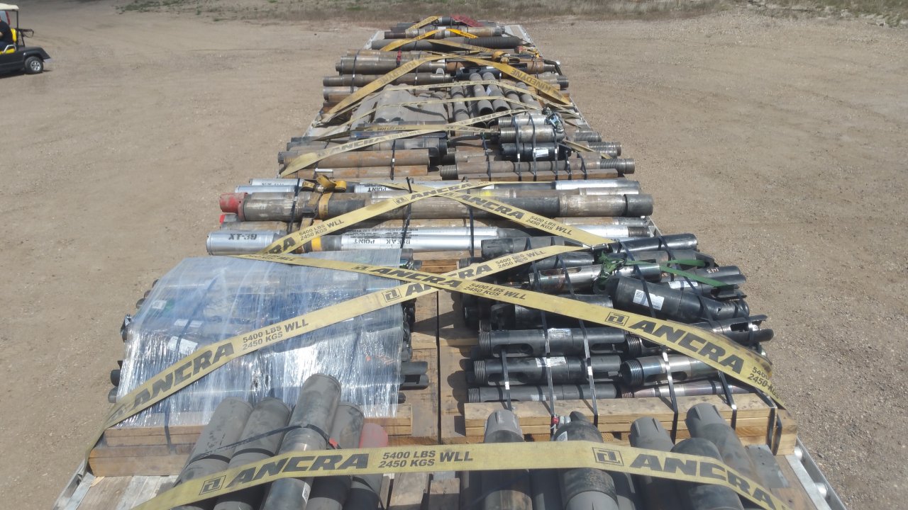

    I'm a tad over a year and LEARNING flat deck. The more types of loads I haul the more equipment I want to have, within reason and how much I can fit in the side boxes and headache rack.
    I have 20 4" winches, 8 2" straps with winches, and 6 1" straps with winches. That's in addition to 9 3/8" chains.
    I had a load last month that took ALL my straps and winches, and fortunately there was a truck stop next door to buy four more 1" straps. I could only get 15 pallets on the deck. I couldn't take more.
    The load was all pallets of "subs", each weighing from 30 lbs to hundreds of pounds. The bad part was the subs were oriented SIDEWAYS to the deck. This required cross strapping and in many cases breaking the bands to be able to cinch wrap at least the top layer of subs.
    I pulled this load 1000 miles, having to stop a dozen times to push subs back in after they extended beyond the rub rail. Fortunately that was only happening on the front passenger side pallet. All other pallets were fine. 20160516_150834.jpg

    This photo you posted is a great example of what a lot of "older" seasoned flat guys DONT move.
    Too stressful.......We like easy strap n go material that's Hard (Which means Once its winched down,It doesn't get loose.
    Couple examples of what us guys book- Uniform steel Tubing-NOT PIPE
    Roofing Shingles- NOT ROLL PAPER
    Solid steel bars that are banded together uniformly-
    Wooden Crates sealed
    A steel coil- NOT MULTIPLE COILS
    Tarpless Lumber from a Top rated lumber Mill (Weyerhauser- Abitibi- potlash)
