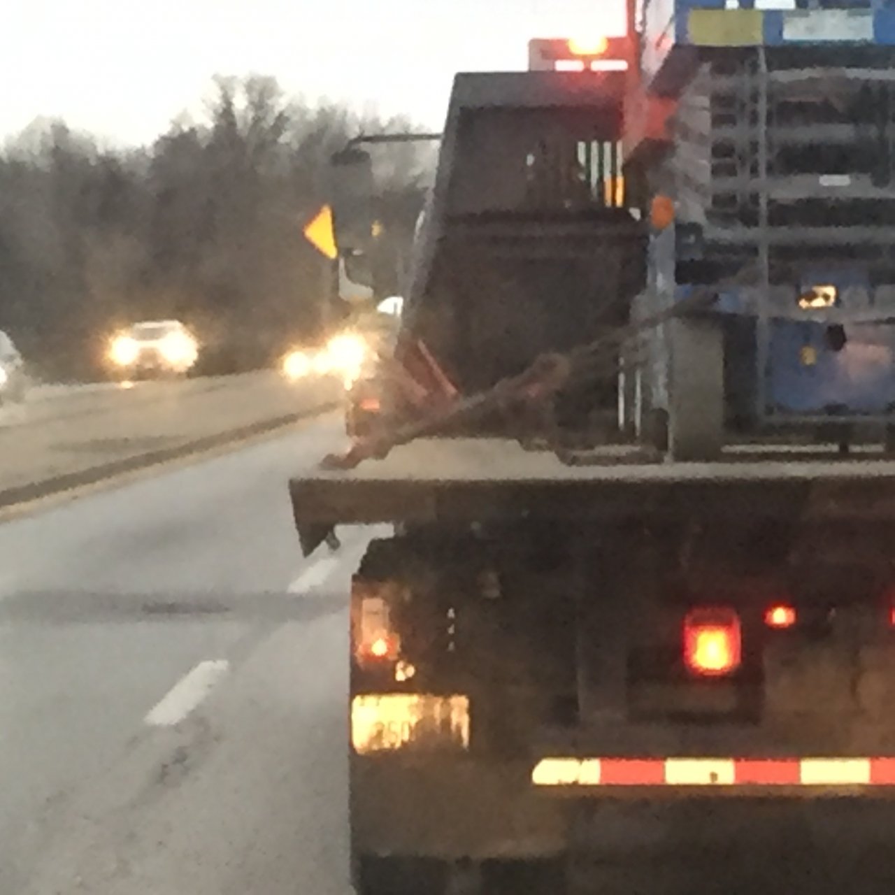

    Back in my flatbed days, this was one of the things I was taught not to do...

    Is the binder hooked to the truck? Is blurry when I zoom in.

    That's what it looks like.

    What I take issue with is the handles sticking straight up in the air like that and not locked against the deck.
    That situation there is practically begging for his chains to loosen up.
    Lepton1 and Chewy352 Thank this.
