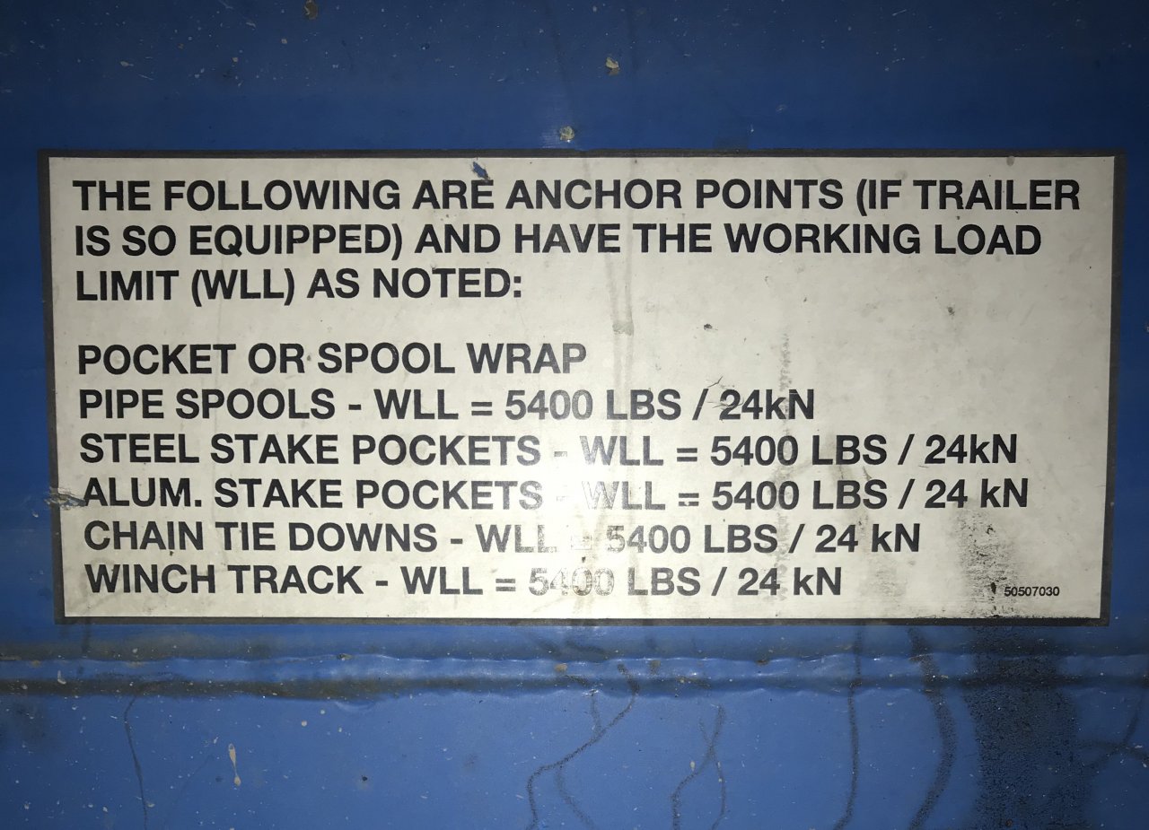

    You're right, I just looked at my manual and my pockets are 5400 on a 2013 Infinity.
    Thanks.

    5AB3F1F0-A5CB-4B8E-8EAD-ABDF8D7F0A28.jpeg @fargonaz I’ve got this sticker on the front of my 2014 Infinity TX
