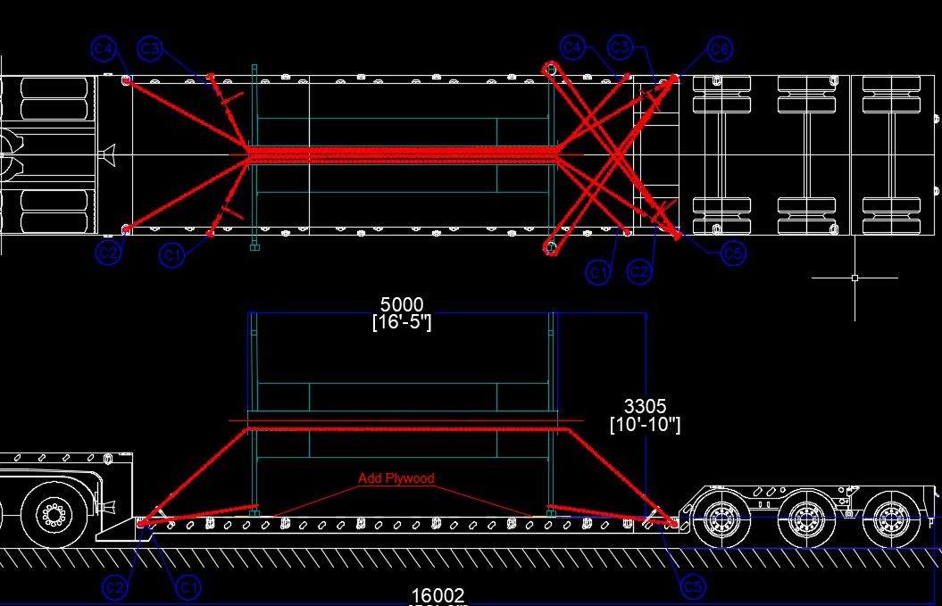

If you had read the OP and looked at the diagrams provided you would note that he is loading the reel "shotgun" on a double drop trailer and I can say with certainty that he has a nine hundred ninty nine in a thousand chance or better that the trailer is built of high strength steel with very little if any aluminum and is set up to use 1/2 inch grade 70 chain.

Exactly. I was trying either types. to see which is more cost efficient and less time consuming. although as some already suggested 6 chains even when crunching in the numbers I still fail with deceleration. I won't be allowed to pick up from this client without proving the reasoning behind my # of chains and location.jamespmack, x1Heavy, Lepton1 and 1 other person Thank this.
looking at your tie-down plan if you move C9 and C10 back to hold against the front of the reel and they are 1/2" gr70 then if you can run a single 1/2" chain from the trailer behind C3 over the mounting frame and back over the frame to the trailer behind C4 as a "tripping stopper" then you have 33,900# of deceleration (32000 required) and all the other requirements are also.
you could add 2 3/8 gr 70 in the C1 and C2 positions as extras and you bump the decel to more than the load weight.Last edited: Jul 24, 2019

FYI this worked with (x6) 1/2" GR70 chains. Thank you all for the suggestions and help.

FYI this is the better version with the same setup would be clearer to all.jamespmack Thanks this. -
