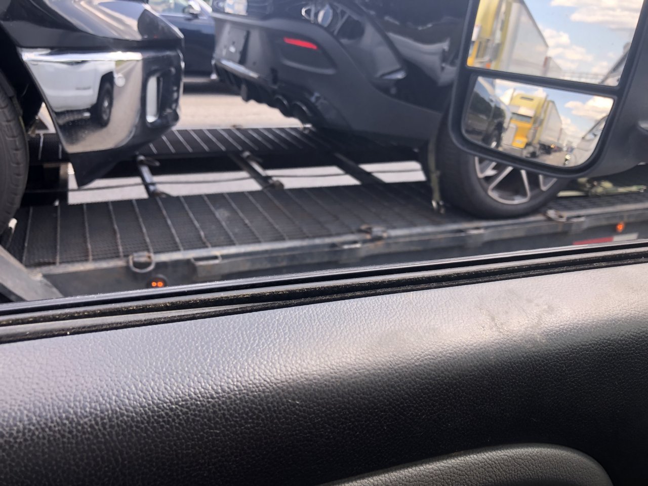

    took this pic yesterday
    Camera focused on the door glass but you can still see the strap hooked into the deck mesh
    Which I’m sure has no load rating at all , and im wondering if they have a backing plate or something to spread the load on the bottom of the decking
    I see a lot of em done this way so it’s pretty common

    I'm pretty sure that's backyard engineering and no, I don't believe that metal grate has the load capacity. It's just too thin, I looked at it s an option for my trailer but knew it was too weak by looking at it. The stuff the car trailer manufacturers use is like 1/8th inch thick expanded steel. Much more heavy-duty.
