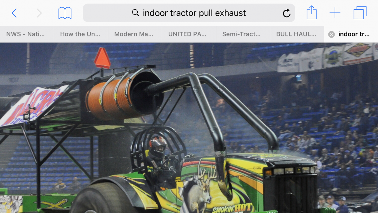

    I think they collect the the smoke in a filter system now believe it or not?

    That certainly takes all the fun out of it. :biggrin_25516:
