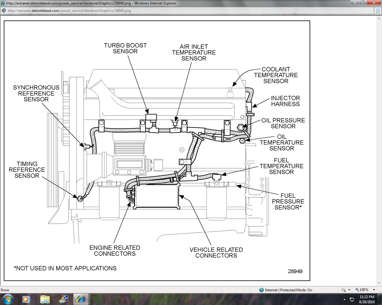

    I'd put money it's your oil pressure sensor, do you have any codes coming up and does your pressure gauge fluctuate?
    Oil pressure sensor is located on drivers side, above the starter- it will have 3 wires going to it and has an 1 1/4" housing to put a wrench or socket on.
    The oil temperature sensor is located just under the pressure sensor image.jpeg

    Oil pressure steady as normal oil has no fuel or water thanks for the drawing
