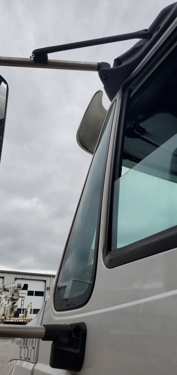

  8. flood
    flood Road Train Member
    4,169
    4,053
    Dec 25, 2010
    This is what the one on my prostar looks like, your should be simular...
    It's the end of the brace that pops lose to allow it to move if hit... 20220418_111110.jpg 20220418_111110.jpg

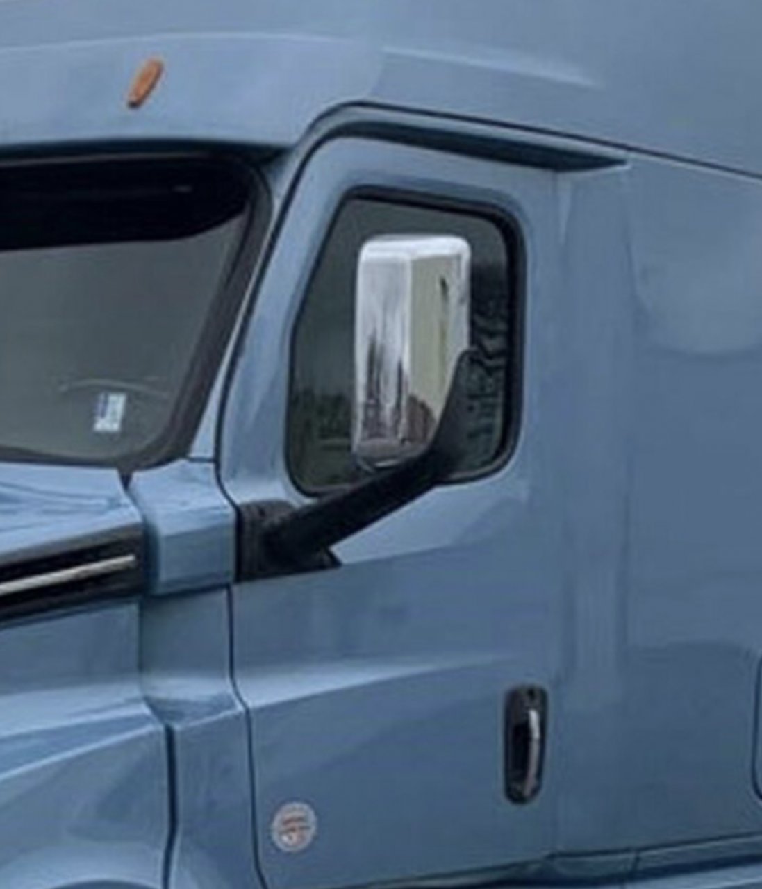

  9. JoeyJunk
    JoeyJunk Road Train Member
    8,762
    68,034
    Dec 31, 2010
    Washington, PA

  10. JoeyJunk
    8,762
    68,034
    Dec 31, 2010
    Washington, PA
    There is a break away funtion in that arm so to speak.
  11. Commuter69
    Commuter69 Road Train Member
    1,148
    635
    Jul 2, 2014
    Thank you... I would have posted a picture, but you beat me to it....
    Like I said, does anyone have access to a diagram? Is it easy enough for someone who has basic skills to fix?
