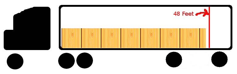

    Here's my rule of thumb:
    1. Unless the load is really light, like 38k or less, make sure they load it in the first 48ft of the trailer. This will help you to stay within the bridge law while still maintaining legal tandem weights.
    2. Set the fifth wheel so it is centered between the drive axles. You'll most likely be able to leave it set there and never touch it again.
    3. Set the trailer tandems so the the rear set of tires just barely protrudes beyond the end of the load (six inches or so). If the load is forward of 48ft, you should be good for bridge law.
    Weigh the truck. If your steers are good (11,500 or so with a full tank of fuel). Then you likely never have to worry about moving the fifth wheel.
    The weight on the drives and tandems should be pretty even. The overhang on a 53 footer doesn't seem to add much weight to the tandems.
    I've done it this way for a long time now and rarely visit a Cat scale unless I know for certain the load is close to gross. If a shipper has a scale, I might double check my axle weights... it's always legal.

  9. lilillill
    lilillill Sarcasm... it's not just for breakfast
    5,642
    13,472
    Nov 7, 2007
    Possum Booger, Alabama
    Make sure your drives and tandems are at the ends of the load and that the load is evenly distributed, like this, and you'll probably never have to see the weighmaster in person.:biggrin_25525:
  10. Jfaulk99
    Jfaulk99 Road Train Member
    2,914
    1,652
    May 16, 2009
    Couch
    I fixed it for you!
