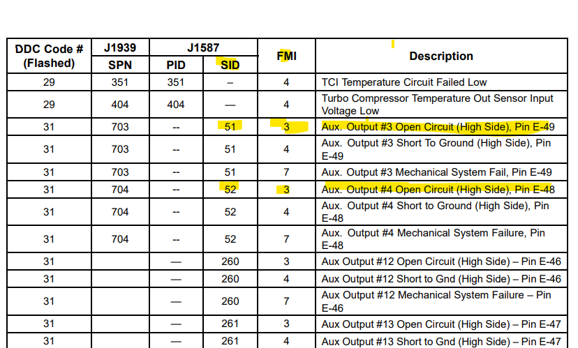

    60 series 14L
    There it is.. the fan switch used to work but now when I press it, nothing happens.. now it doesn't, recently replaced the ECM..
    What do these mean in particular?

    27 172 172 -- 3 Air Temperature Sensor Input Voltage High
    Looks like some wiring problems. Note that the first 2 are constant and the 172 is Intermittent. Pull off the connector(s) at the ECM. Make sure that no pins are damaged. Make sure pins E-48 and E-49 are there. Maybe ECM not exactly correct.

    wire problems was the culprit right on the money.. the only thing now is.. my fan doesn't kick on at 200-210 now.. the fan doesn't kick on when the AC is switched off... not sure what it is.. I replaced the temperature sensor and ECM... It might be the thermostat ? I'm not sure if I installed/oriented it correctly. I'm currently searching in the service manual to verify
