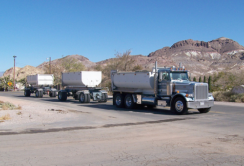

    I am from lake tahoe /reno nv. WE get around 140 to 175 per hr depending on the paving company. And or if triple slam bang or just one trailer.

    What's a triple bang slam?

    I've seen pictures of those but never seen one in person. I've never checked for sure by fairly certain pulling triples isn't allowed here in Nebraska. I see them in South Dakota on the rare occasion that I'm up that way, though.
    Genuine question: What are the advantages to pulling a setup like that versus just a triple or quad axle side dump?
