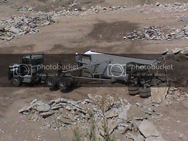

    side dumps do not fall over when unloading on uneven or soft ground end dump wreck.jpg

  9. Qbf594
    Qbf594 Road Train Member
    1,642
    8,715
    Aug 15, 2019
    Southern Canadian annex, NY
    Oof....
