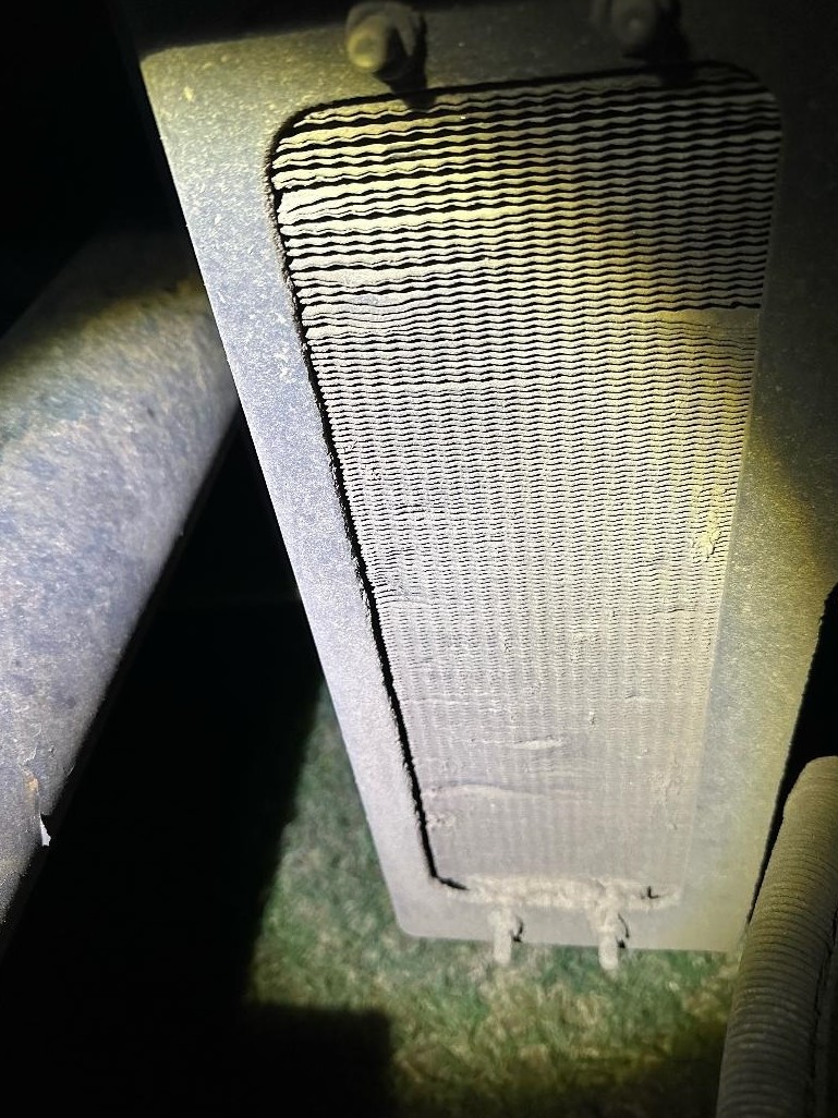

    Mine has a fuel cooler on it as well, my tanks would get so hot that it would almost take skin off you in the summer. I have to warn people not to lean on them. cooler.jpg
