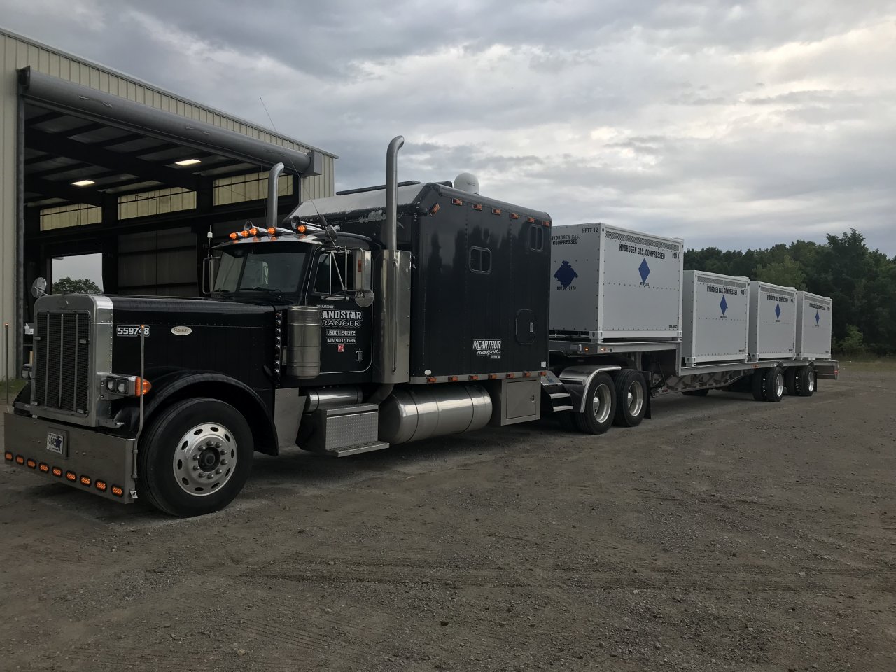

  9. randomname
    randomname Light Load Member
    Joined:
    Jul 13, 2014
    Messages:
    244
    Thanks Received:
    262
    I thought hydrogen is lighter than air.... shouldn’t your loaded weight be less than empty weight.....?[/QUOTE]
    I worked at a place that had a helium trailer, I forget the exact numbers but fully loaded it gained only 2000 lbs. it’s funny to think about, what if it sprang a leak going down the road, at some point between crammed full of helium and empty of helium, that trailer will be lighter than empty. Or something.
    cke Thanks this.
