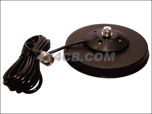

    I have a lil $ tied up and wanna use it...Now seeing im not getting positive result(yet) i wanna see from my set up in my crap SIRIO_MAG145_PL_1.jpg cadia,i been thinkin on a set up for my pick up...
    Saw the siro mag mount....With the mount i have seen pics of,im not sure how to attach an ant to what seems to be a pl259 end on the siro....
    I have a cpl fire sticks and a cpl cheap ext coiled k40's and my duel coil 10k ant would rather use one of them than have to buy another ant...So am i correct in assumeing there is some sorta adapter to run a ant of choice on the mag mount...

    They do make adapters, The antenna farm would be one source. If you do ebay you likely would find them there as well.

    What am i looking for???

    Diamond D38-24 or Comet AD35 M either would allow you to use a 3/8-24 mobile antenna with the mag mount you have pictured in your first post. If you wish to use 3/8-24 antennas exclusively order a mag mount set up for HF antennas from the start.
