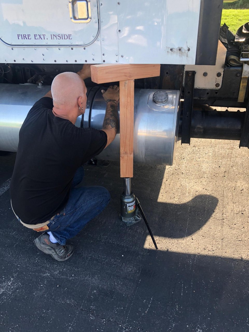

    This was my solution to raising the sleeper since the leveler valve was of no use. There's a safety block between the cab and the frame.
    New bags and shocks on both sides. She sits up nice and level now.
